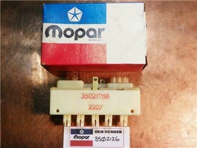

I have yet to get into diagnosing my a/c clutch power situation BUT now the clutch runs all the time! The only way to shut it off is in the "off" position on the heater switch.
I am leaning towards a switch assembly if I cant clean it up.
After installing a "new" NOS switch, my compressor won't shut off in any position. After some diag, I found the new switch to be faulty. The "off" position dose not cut power to the compressor. It only works if I press the "off" button, then pull that button back out manually, then the power is cut off to the compressor.
It turns out my original switch was working as far as compressor control, but not air flow control.
I guess I need another switch. I am tired of removing that thing.
