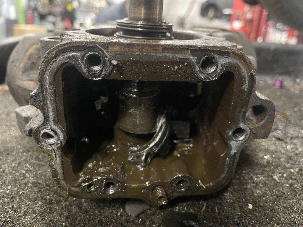

The air conditioning and heater need work so I am getting it going. The compressor would only turn 3/4 of the way, then it would stop and could be rotated backwards to the same spot.
Removing the compressor and pulling the oil pan, I found carnage. I am determined not to let this compressor die.

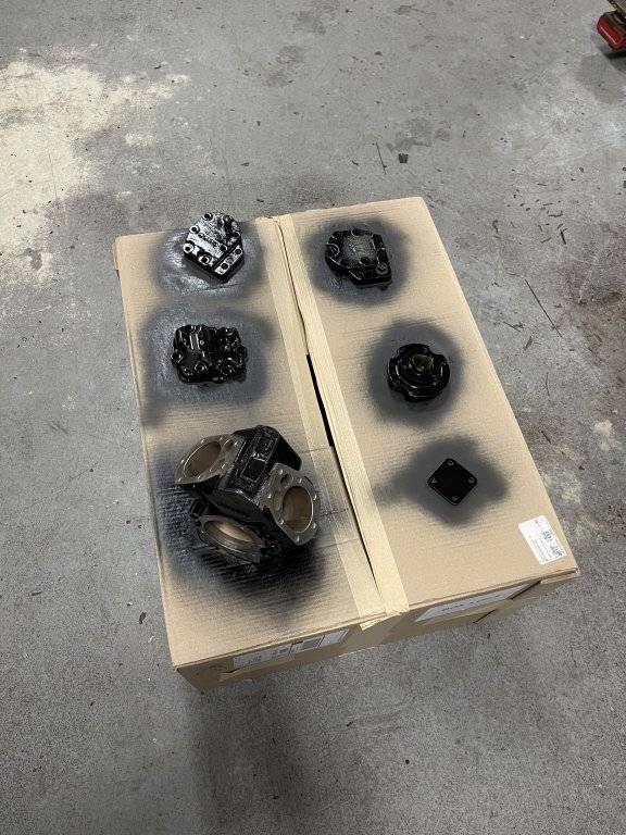

Some sand blasting, a trip through the parts washer and fresh paint and it looks great.
I will be getting the shavings cleaned out and getting it ready to make ice cold air.
The connecting rods and crank were damaged but I think the crank will clean up, and new pistons will get it running.
Gaskets are on the way.
mine did that too..got a new crank from Marty Mopar for 25 bucks...Arizonaparts...looks like he still has 3 in stock...
