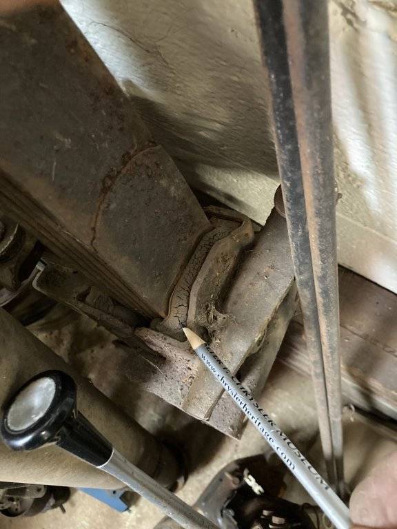

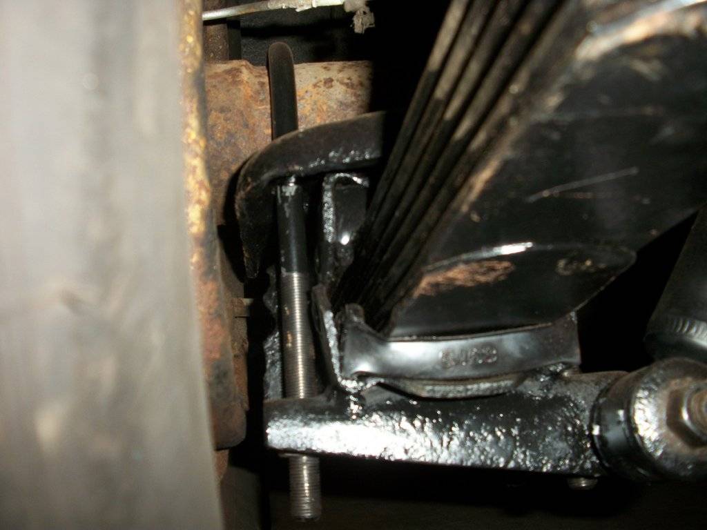

I want to replace the leaf springs on my 1967 Imperial, but the rubber isolator's are all cracked and split. Is there a source for new ones? Or good used? Got my springs from Espo, but they do not have a source for them. Any help appreciated. These are the ones by the shock plates.
Can you post a picture of what you're referring to?

Is that an Imp only rubber pad that is in the spring pack centre, and the centre bolt runs through it? Hard to tell from that photo.
Regardless, one could make something that works well, I would think.
Great pencil by the way!

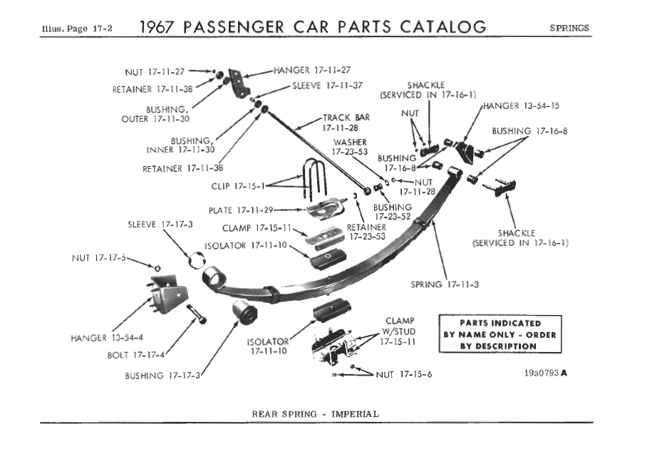

So I did some more digging - and I owe you an apology - you are totally correct with the terminology for that part. Leaf Spring Isolator. Group 17-10-11.
There are two per pack - one above, one below, at least according to the 1967 parts catalogue. They are an Imperial only part, and from what I can ascertain, they also have a central bushing within them to deal with the centre bolt. So a total of 4 per vehicle.
The part number is 2403 456 I expect they're the same for 68, if not the same for 66 as well, since the cars are very similar. I haven't checked the parts books.
Where to find them? Who knows? No joy on PartsVoice. However, I would talk to the truck and large car spring people - I expect there are alternatives that would do the job.

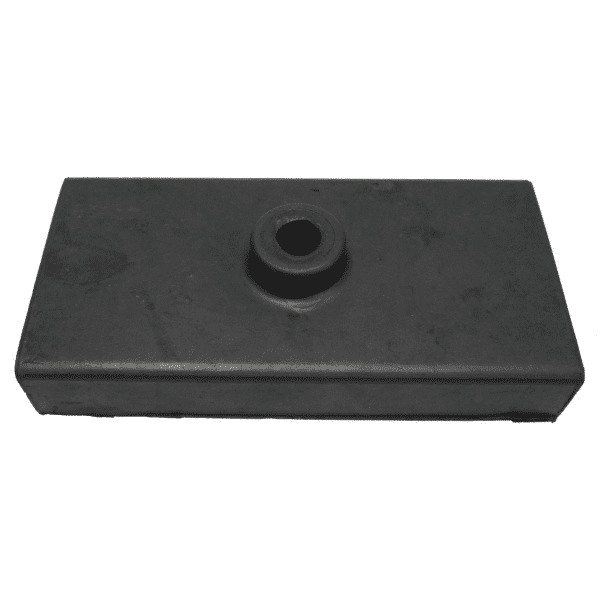

Rummaging around on Google comes up with things like this:
Leaf Spring Isolator Pads by Energy Suspension
They even have the little bushings... so perhaps, not all is lost. I expect one could carefully drill out the centre hole if required, and install the bushings...

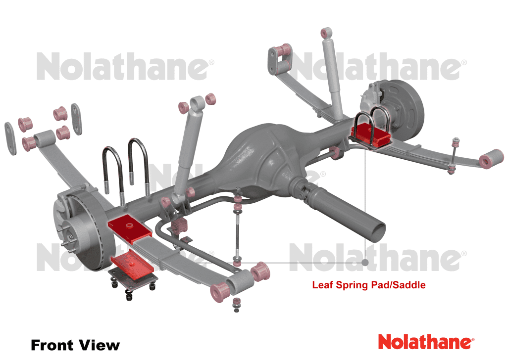

Nolathane also makes similar products:
Steele Rubber makes similar ones for Ford full size cars:
1964-1973 Ford Rear Leaf Spring Insulator | Steele Rubber Products
Whether these are the right size is a research question, but there is hope!
