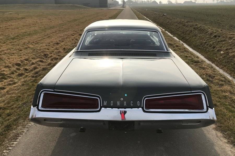

1967 Monaco taillight:

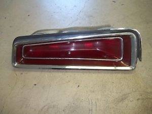

Now, the reason I ask is that I found a decent pair of 67 Monaco lights BUT they are like this:
I know it's nitpick crap but my 67 Monaco has the inner chrome stripe like the ones in the first Monaco picture.
Anyone have any idea why this would be? Doesn't seem to be specific to the 500s. A mid year change?

It's possible the Monaco had its' tail lights changed out early in its' life (vandalism perhaps?), or perhaps Monaco tail lights were out of stock on the assembly line and Polara lights substituted.
I guess, but these aren't Polara taillights either. They're Monaco lights without the inner chrome trim... ?!! What's up, Ma?
Just a shot in the dark. The difference seems to be the inside loop chrome trim. If this was a press fit chrome piece perhaps it was simply removed at some point in history. Alternatively if it was a chrome paint finish someone may have buffed the finish off?
I am not that familiar with Monacos, but I ran across a turbine bronze '67 4 dr about 30 years ago with a star pattern in the tail light lenses. Do all Monacos have this? I do not recall whether it had the chrome loop or not.
I wonder if there is more than one variation, or if the aftermarket was involved at some point.
If someone has access to one with a star pattern lens, please post a close-up photo.
The silver part of the Monaco's tail light is just a flimsy separate tacked-on plastic piece, easy to break or lose, which likely is what happened in the case of that car.

Ah .. I should look closer at mine. I always took it for granted that it was some sort of applied chrome, not a separate piece.
Goldfish65 gets the "ding ding ding" on this one. Looked at mine last night and they are indeed flimsy and indeed falling off.
So yea, there you have it.
