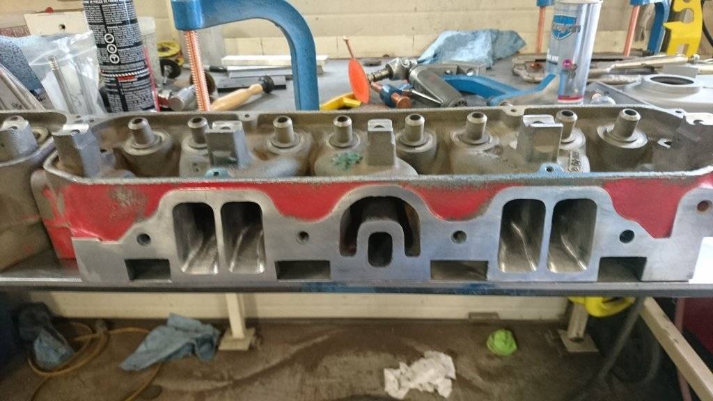

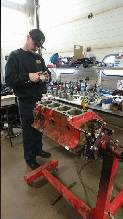

Just making a quick post on a build I'm doing for my girlfriends 1966 Windsor.
It's a 38,000 mile beauty. The motor looked great inside.
New:

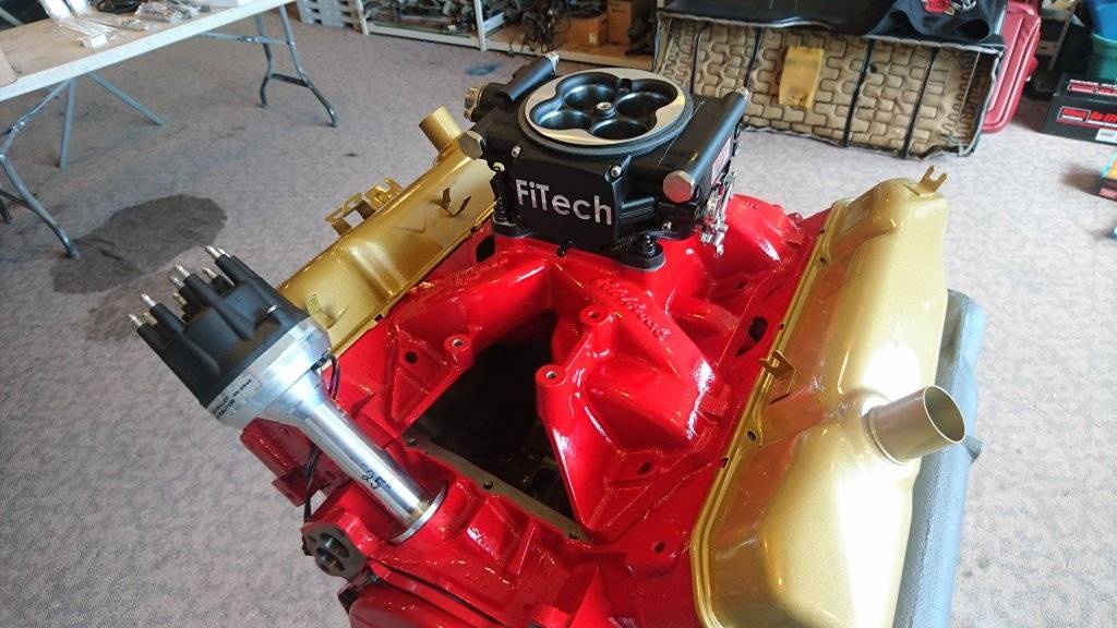

Bearings, timing chain, Comp 221 Xtreme energy, pushrods, valve springs, retainers, locks, oil pump, performer RPM intake, balancer, aluminum water pump and housing, MSD distributor, box, wires and coil, gaskets, roller rockers, and a Fitech efi setup. A few other odds and ends, blah blah blah. Car is also getting Wilwood brakes, FFI control arms, all new front suspension, Ridetech shocks, and more blah blah blah.
Looks good and should run great. I'd be concerned about hood clearance. Looks as though you've added few inches with the performer intake and the caddy air cleaner. Great looking Windsor BTW.
Yep once I mocked up the parts I instantly went oh sh*t..!! haha. Will find out if it fits once it's back in it's hole in a few weeks.
