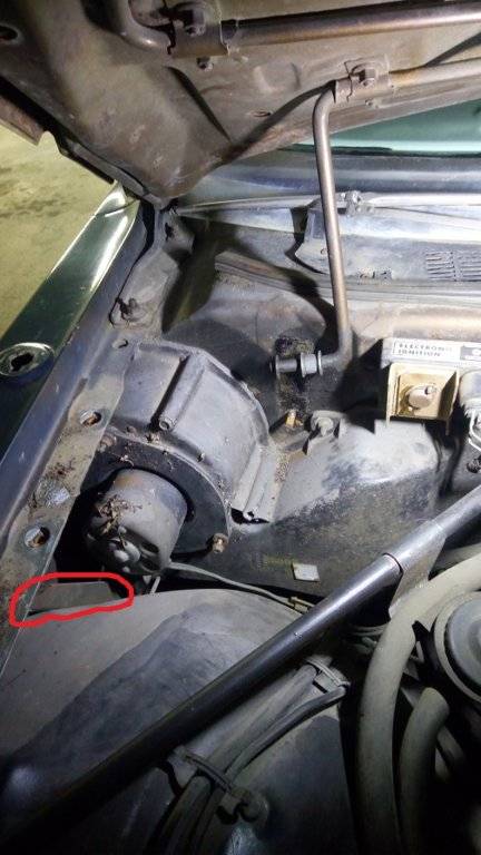

To acces to it, I removed the hood compensator and unbolted the inner fender panel, as mentionned in the Haynes repair manual. I can't remove in totality the inner fender panel, but it is not really a matter. My big problem is the bar, circled in red in the pic, that seems to be bolted close to the subframe (down) and welded to the fender (up). And the bar is bloking the blower motor, impossible to remove it from its airbox.
Has anybody encounterd the same problem? What if I cut this bar? Will the car behave like the Bluesmobile at the end of the movie (haha!)? What can I do to remove the blower motor?

I think there are a couple of spot welds that hold that bracket in place. If you unbolt the bracket from the frame, the spot welds can be drilled out to remove the bracket. You can put small bolts in the holes when you are done. Second method would be to remove the whole fender to get all out of the way. Have you checked to be sure the resistor for the blower motor has not failed. Resistor failure is actually more common than a failed motor. The fan selector switches were also prone to failure.
You can test the motor by running a lead from the positive terminal on the battery to the power lug on the motor to see if it will run. If the motor will run using this test, the problem is probably either with your switch or the resistor.

If the blower motor is bad. The car must be jacked up, tire removed, inner fender removed, brace removed in order to access and replace blower motor.

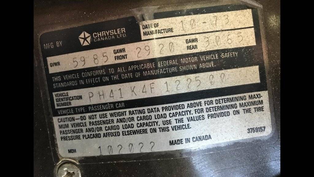

If you find a door sticker like this:
you will know the exact day your car was completed. Mine, for instance, was built October 20 (the first four digits of the MDH value). Only mine is not an export-spec car, as it was sold new in North Carolina during the summer of 1974.

@PeugFra ,I don't have this door sticker anymore. Actually, I never had it. My car started life as brown color, but for an unknown reason, has been repainted in blue. So the sticker door must have disappear during this occasion?

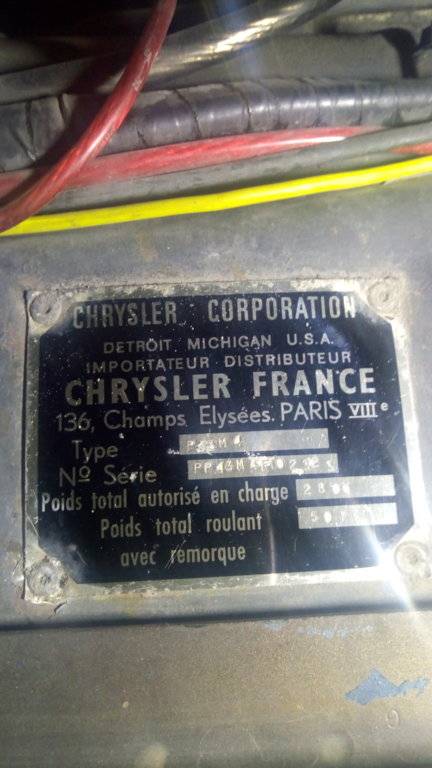

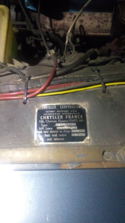

But, I have the original importer tag, on the inner fender. Here is a pic of the tag :
And a closer view :
A nice tag, when Chrysler France headquarters used to be located at 136, Champs Elysées, Paris. Basic info, nothing else than VIN, nominal weight loaded, and maximum weight with loaded trailer. But it's a nice tag.

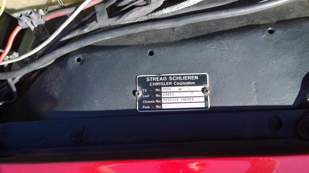

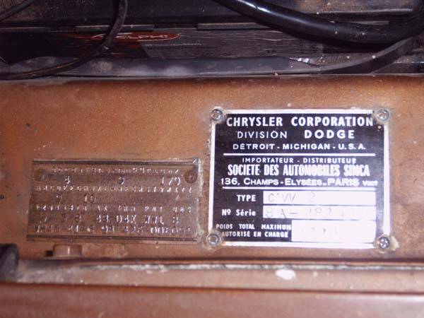

That tag must be what they call a "plaque constructeur" or "plaque d'indentification" in French classic car circles. This is probably from a pre-1969 Coronet station wagon, as it seems to read WH45:
And for a 1975 Gran Fury that was exported to Switzerland:
