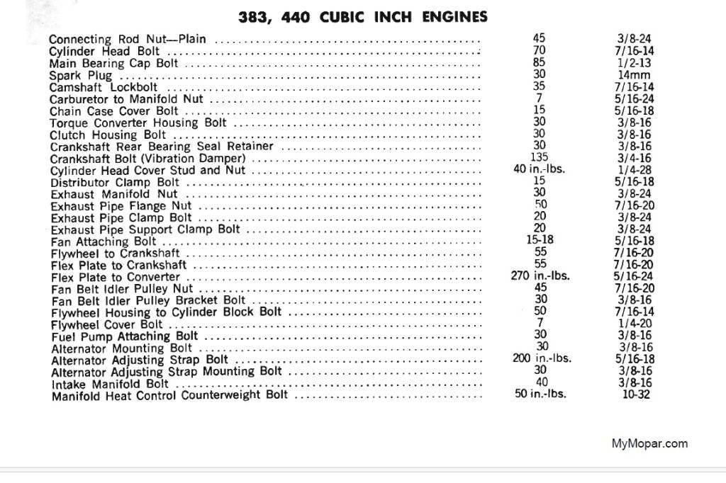

FSM page 9-30 says:
Mount bolts 30'lbs
Adjuster bolt 12.5'/200"lbs

Here's part of the torque specs from the '69 Plymouth manual. Chrysler would be the same. Note they are in ft/lbs. except as called out in in/lbs.

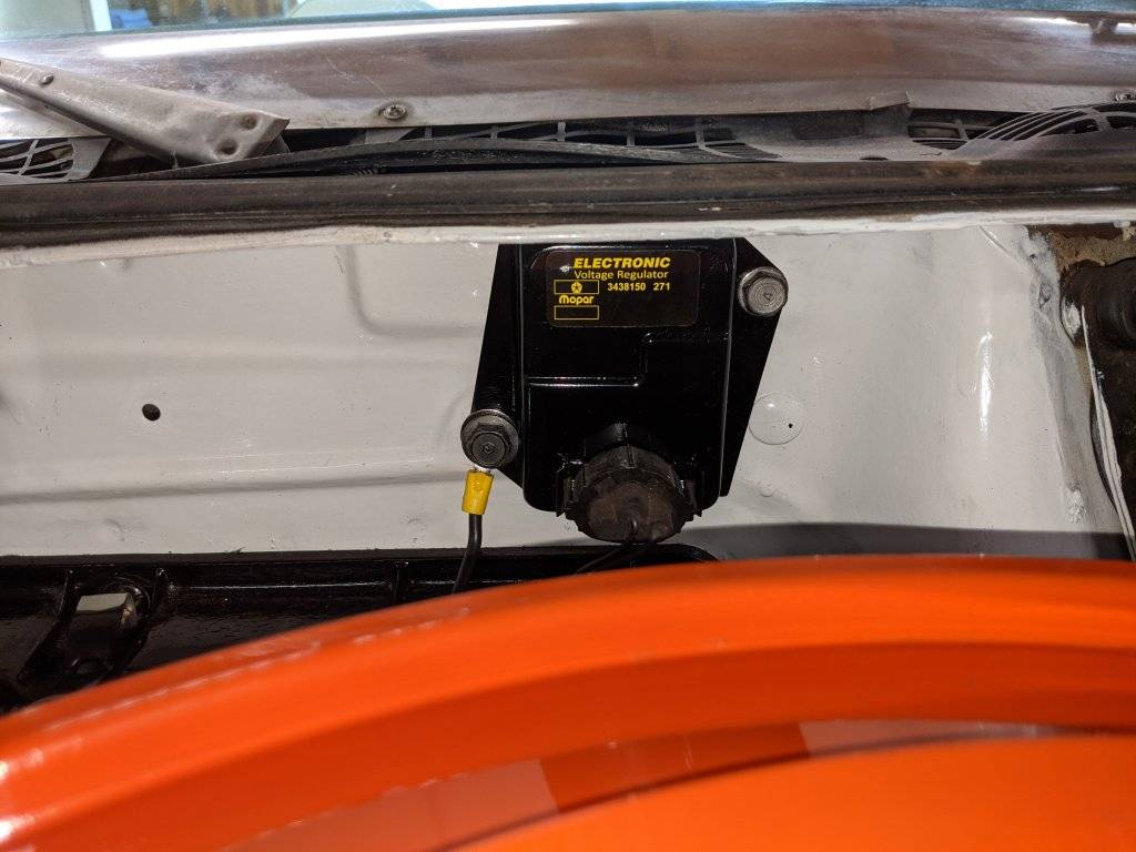

I had a 1969 Monaco that was one-wire field wiring from the factory. Are you going back to stock from the flat pack voltage regulator (see below)? I had nothing but trouble with 1 wire voltage regulators, but I hear they are better now because of electronic internals rather than mechanical internals.
Love the electronic flat pack voltage regulators, 2-wire system that came out in 1970!!! Mopar brand has been excellent quality for me.
