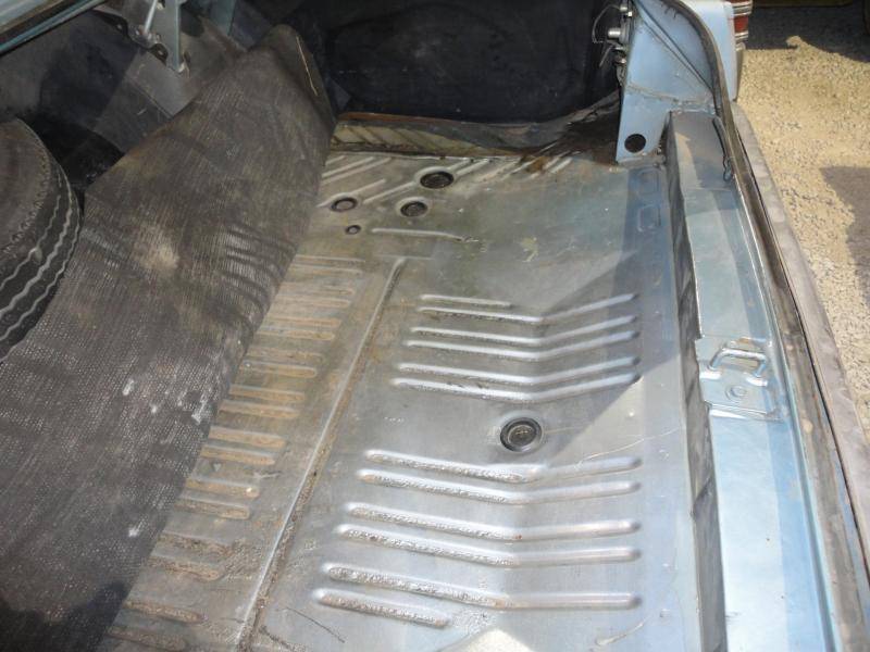

Maybe get some color correct turquoise paint mixed up for you and in some spray cans after some sealing primer.
Kudo's on keeping on working on and improving the car Stan

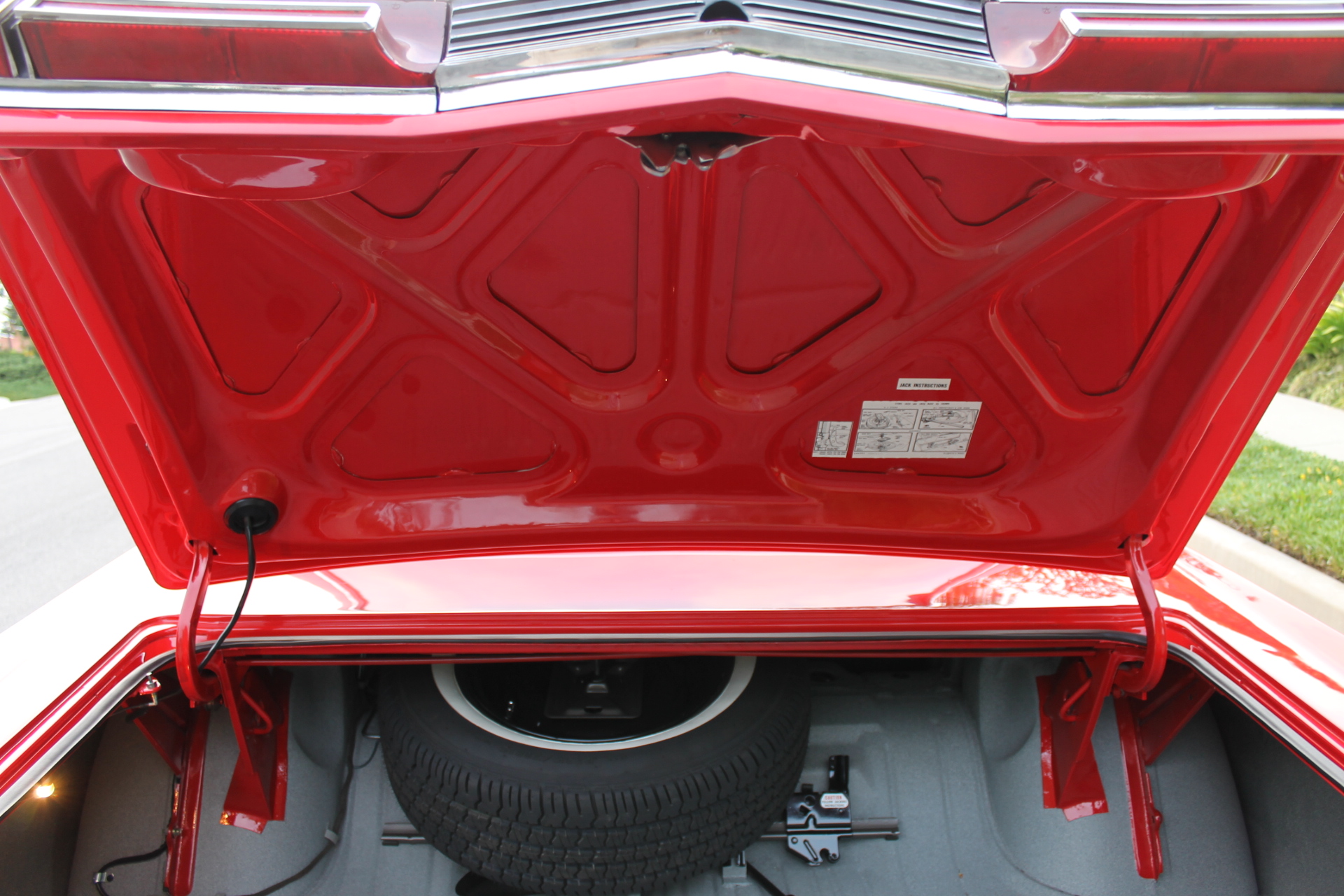

Or you could go for this look

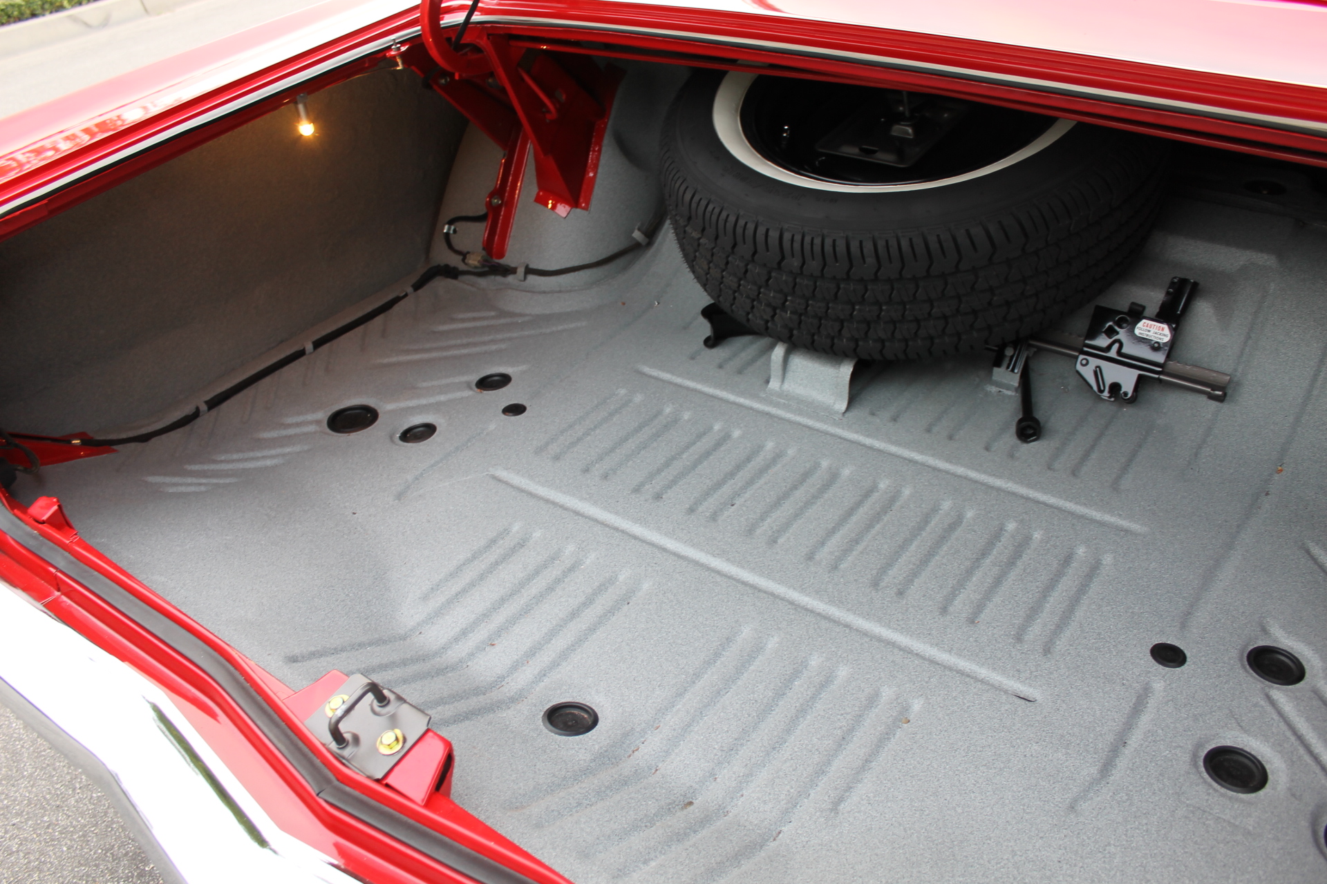

Both these options are the best IMO. A good primer, and paint would be my first choice, and leave it at that. Or do the primer and paint, and then the trunk coating. I do not like rust "encapsolators" and especially have no love for POR15. All snake oil products to help hold water under the coatings and have things rust out faster. ;)
That trunk with the masked off trunk supports, and the light grey coating just looks amazing! The attention to detail is top notch!
I have never seen a C-body in these years with body color in the trunk except the bottom of the deck lid.
Basically from the trunk seal inward I believe it should have had a medium gray speckled paint with a gray plaid mat.
I recall many with body color overspray over the gray speckled paint.
Or was that on Fusies?
S%&$ I can't remember all this stuff anymore. Grr...

Silver Bullet and gray speckle. That's the way I'm going .

Fusey... as I recall we had this discussion before and the trunk in the slabs were all a spatter paint( or whatever its called, lets call it trunk paint). Doesnt Scott (Rexus) have the answer?

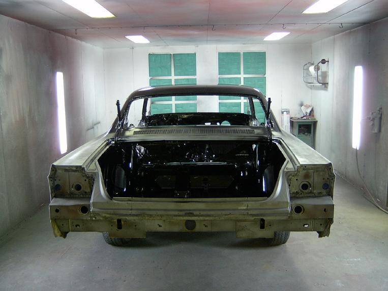

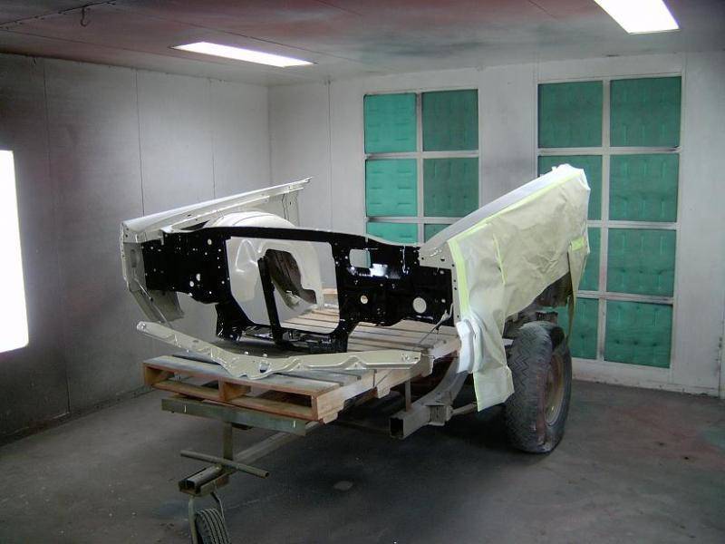

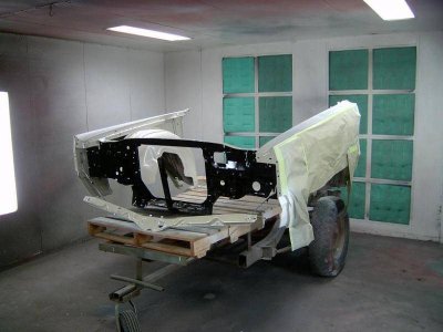

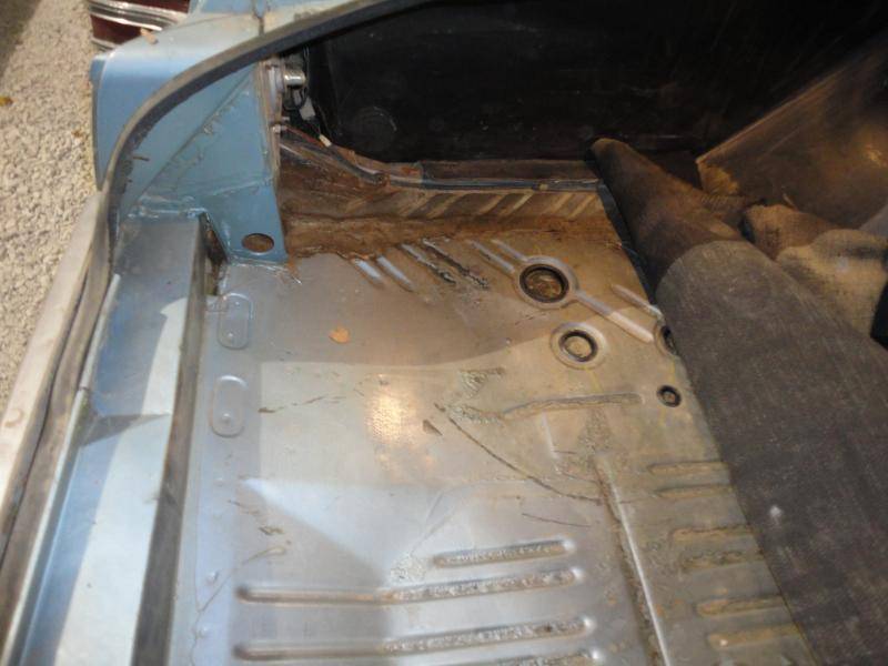

I blasted this clean with silica... trunk, engine comp, sub-frame, floors, jams etc. The roof under the vinyl was sanded bare with 80 grit.
I then shot it with POR15 excluding the top half of the firewall, inner fenders, jams etc. I didn't use it wherever it was going to be top coated with body color.

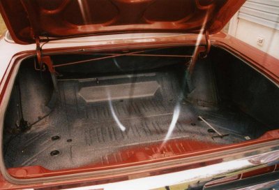

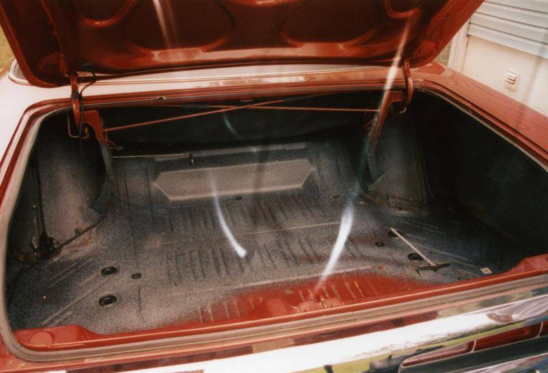

I hope the picture posted, to help out. my 67' new Yorker trunk, unrestored original is painted the color of the car.
if that is the question.Lol

Well, since the car is not getting painted, I'll settle with Mopar trunk paint over rust converter.
The real issue was how the factory painted the trunk and now I know. Thanks for all the input.
Krylon Gloss Black anyone? Lol :D
What about Rust bullet Stan? I've heard alot of good things about it. Someone on here did their front stub, and underhood area with it, and it looked great. Thats what I'm planning to use on the blumo. Some $pricey$ stuff though!
Silver bullet was a dream to spray and I liked the finish better than POR-15. POR-15 always looked like Dip when it dried.
