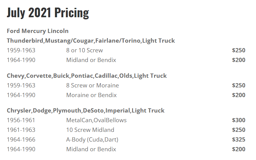

What is the going rate for a rebuild these days ?
It's a Bendix unit.
It's a Bendix unit.
From Booster Dewey home page....plus shipping to-and-fro.
