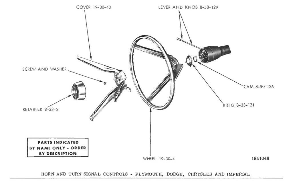

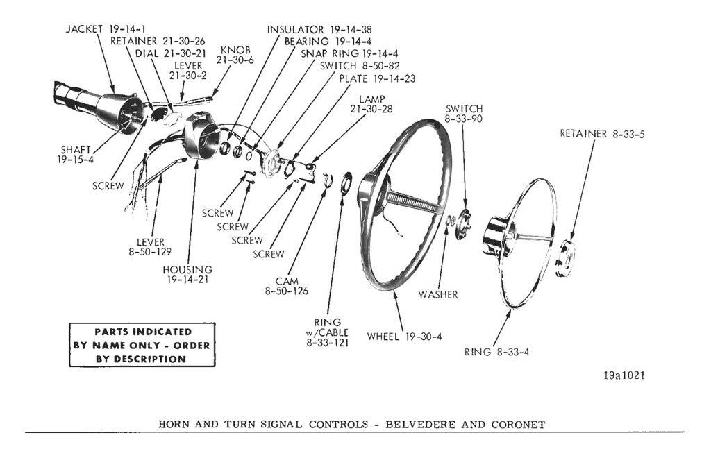

As far as I know in 67 there was only one switch, pushing the spoke just rocks the switch is different directions to make contact, no different than just pushing on the hub. The switch normally goes between the wheel and the cover, not shown here (unless it is part of the cover?, maybe there are 3 switches, parts book doesn't reflect that)
This is the B-Body setup showing the switch.
