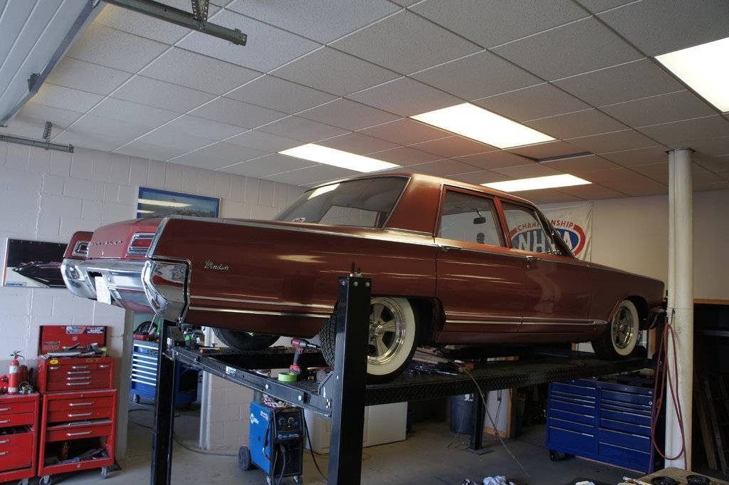

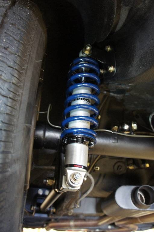

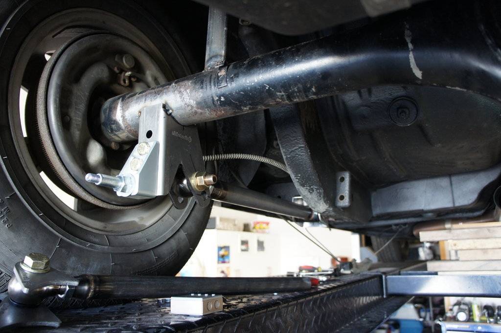

Hey everyone,

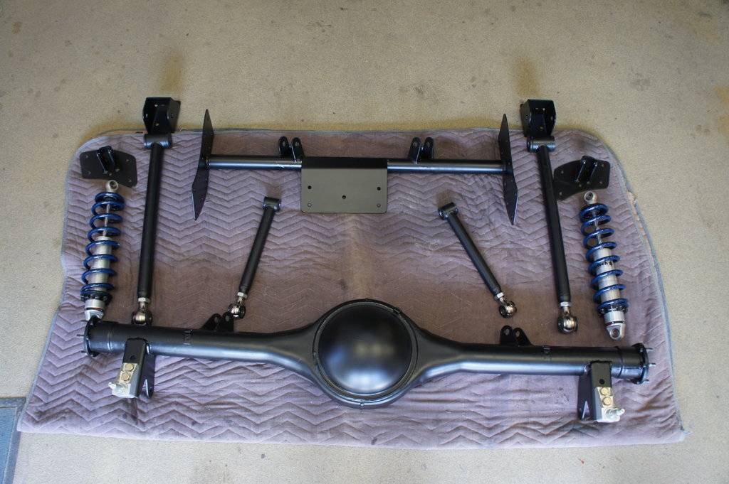

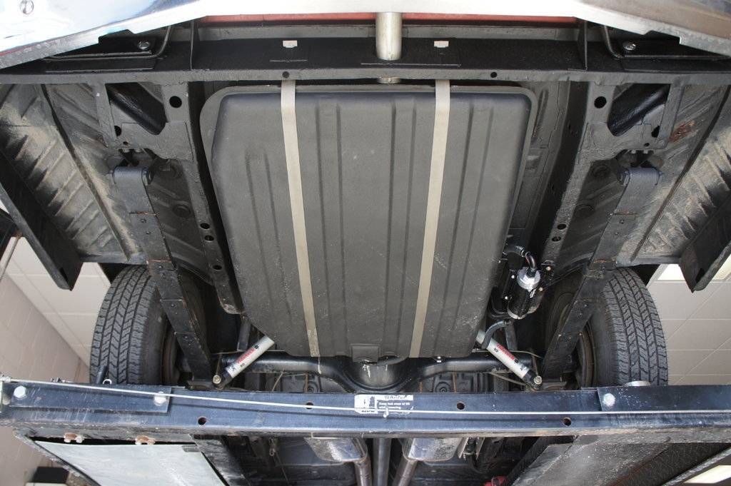

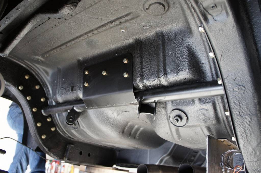

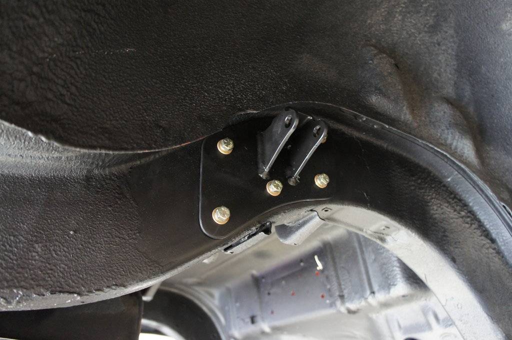

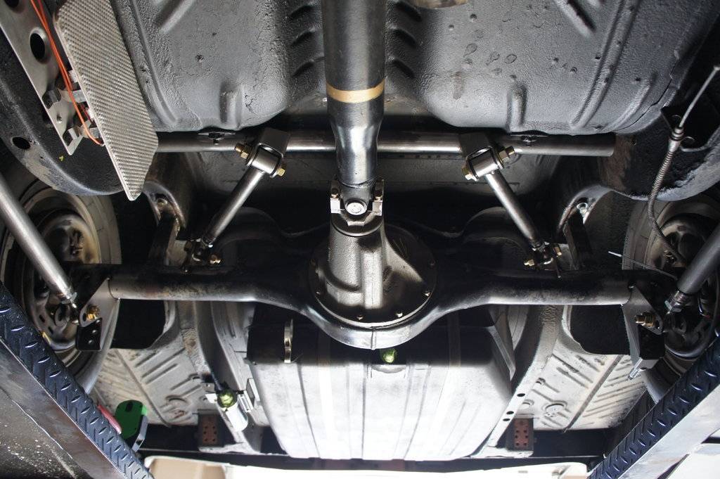

It's been awhile since I've posted. I wanted to share my latest project of a 4 link coilover setup I built for my girlfriends 1966 Chrysler Windsor. I built almost everything from scratch save for the diff mounts.

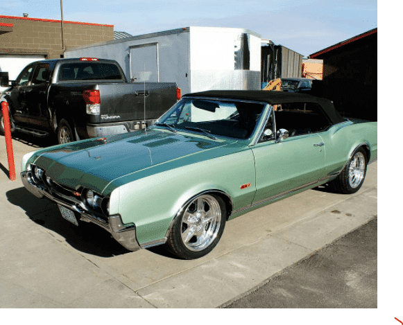

Also what the story one what looks like green dart behind it in the outside pic

I work at a restoration shop. That's one of the body shop employees. If you are on
Instagram check out our page. joeys_place_resto We have a cool 75 Duster build on the go. As well as a 70 Cuda.

I'll comment on the ride and handling.... Holy mother F it is like night and day. So controlled and smooth over the bumps now. And same goes for cornering. It no longer feels like it's pouring itself around a corner. It actually tracks and goes around a corner. I have about 65 hours into the setup so it was no small feat to do. But it was so worth it.
Nice, who says C-body folks cant have nice things. Would be interesting to see out the door price for a setup
I missed this thread before, what did you use for bar ends? Looks like they are bushings and not heim joints. Nice work
