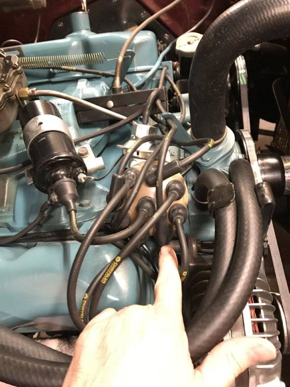

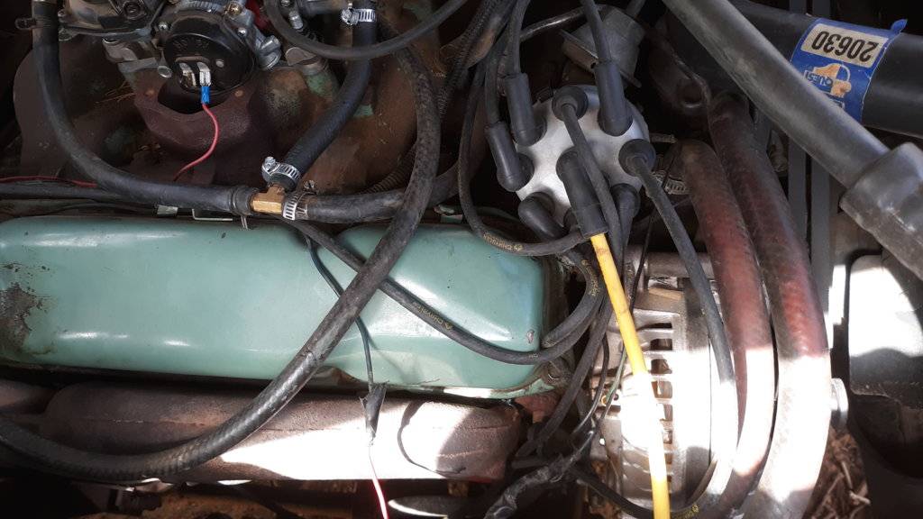

I think at least cyl1 wire is fine.
Hard to tell if the next counter clockwise is 8.
Based on the position of your vacuum advance. You may be a little advanced. I tried to take a picture of the same angle. Mine is set at 7-1/2 advance. Some variation may apply between distributors. My finger is on number one.
The thing people forget to do is mark their current distributor location before removing or messing around too much.
