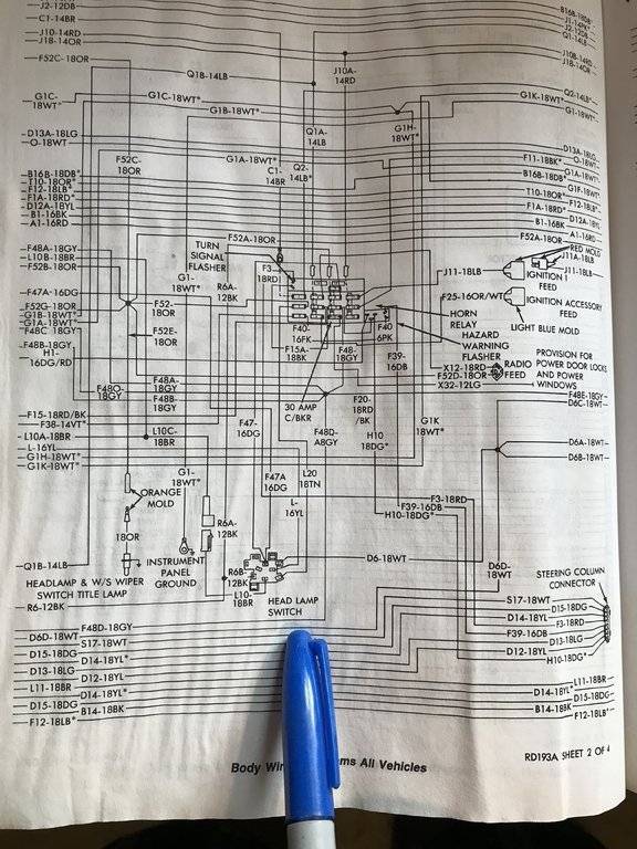

1983 dodge d350 Royal SE crew cab dually prospector. Other forums have said the problem is the draw of the running lights is too high due to the clearance lights on the cab, tailgate lights etc. I have the FSM here is the diagram.
That makes some sense. The circuit breaker is seeing too much current and doing its job.

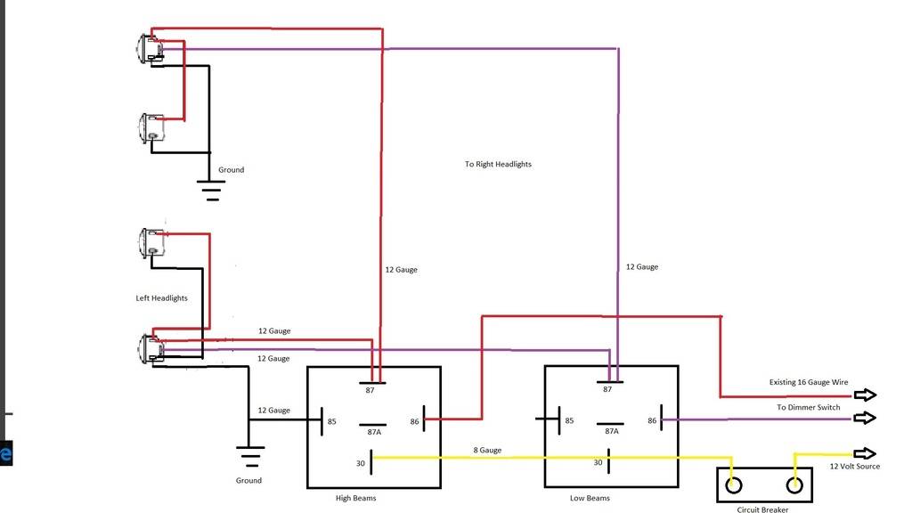

I've done headlight relays on my car and made up this wiring diagram.

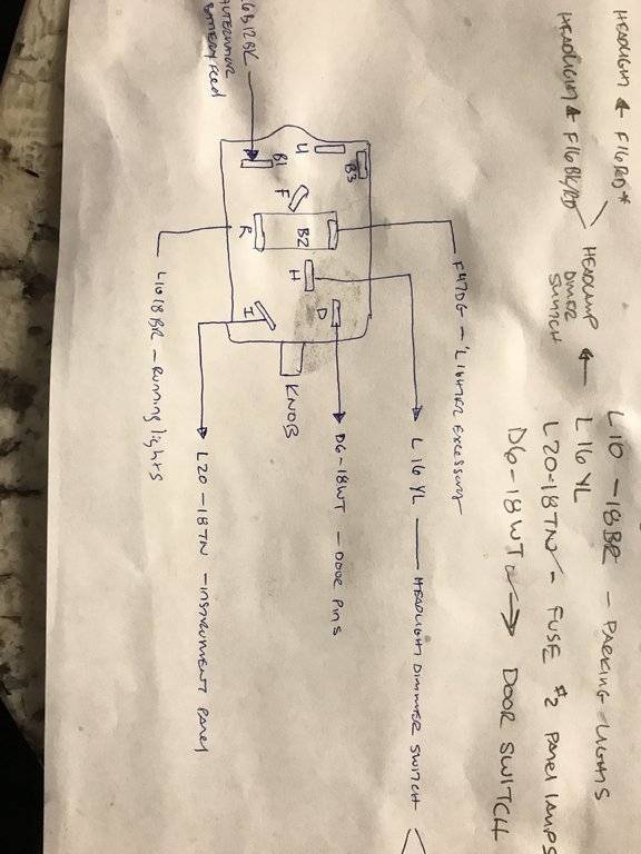

Ok here is the update on the truck head light issue. I took out the switch I just installed and checked it with an ohm meter. The ohm meter would only go to 0 momentarily when the knob was partially pulled out. It would not go to 0 ( stayed at 1) when it was in its correct stop location.
I went to the parts store and replaced it ( lifetime warranty) and checked it before installing. 2nd new switch had the same result with the ohm meter.
There is 12 V power going to switch but it seems as though there is incorrect contact within the switch. No power leaving switch to running lights tail lights or interior lights at correct first stop location or when headlights are on.
What is next step?
Figured it out. Dodge trucks have 2 power sources for headlight switch. One of the power sources was dead. Got it straightened out.
know this is an old thread. My 1976 Chrysler Newport is exactly what is happening to me. Switch is the same. Went through three switches problem still persisted. Which circuit is the second power source?
