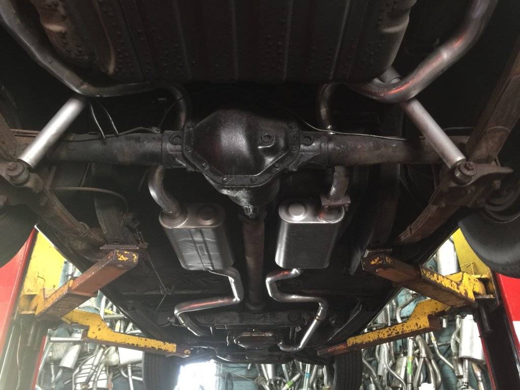

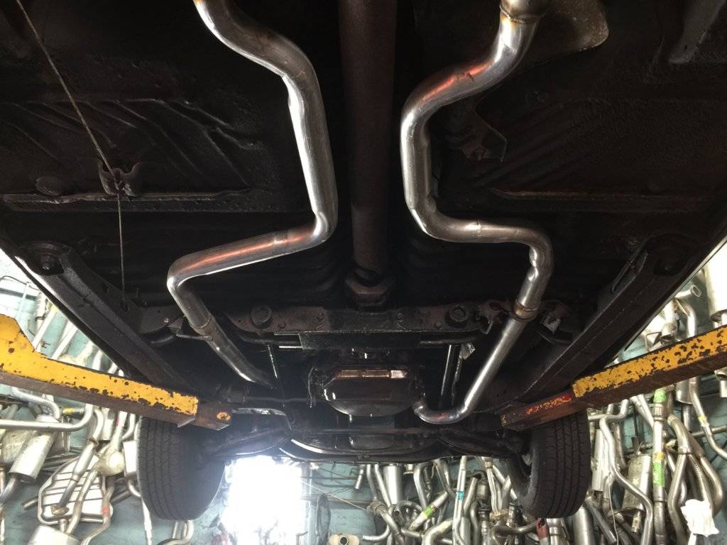

Yep! As mentioned above! No such animal. Have your local ship whip one up for ya. That’s what I did on my 75 NYB.. I’ll attach pics if I can find them.
Let us see how it turns out. Once I get some basics sorted out on my Fury I’ll be getting my rusty, tired, and single exhaust replaced with duals.
That’s with flowmaster 50 series. I have a video of the sound but websites not letting me upload it..
Why no good?
I’m picky about the visual aspect of it. Less bent pipe going into the muffler with Offset in/out.. after the guys were done, I wasn’t completely satisfied with the bending and pipe alignment. But! I didn’t wanna be to bitchy since my car was hostage once they cut the old stuff out.. i watched as close I could while they worked. Just say’en
Looks very good @75LandYacht , tips about offset are very interesting too, and helpfull. That's probably how I'll do. But here in France, working on american cars are not so common than in the US, and for a stainless dual exhaust line, that'll cost me way more than $450...

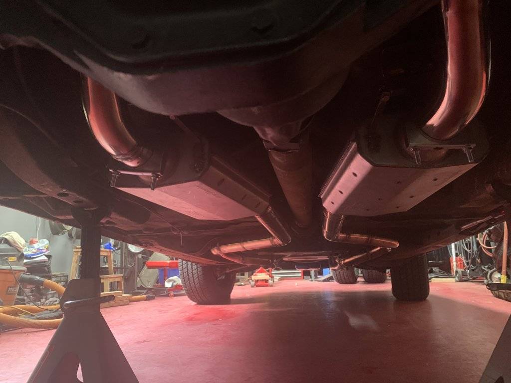

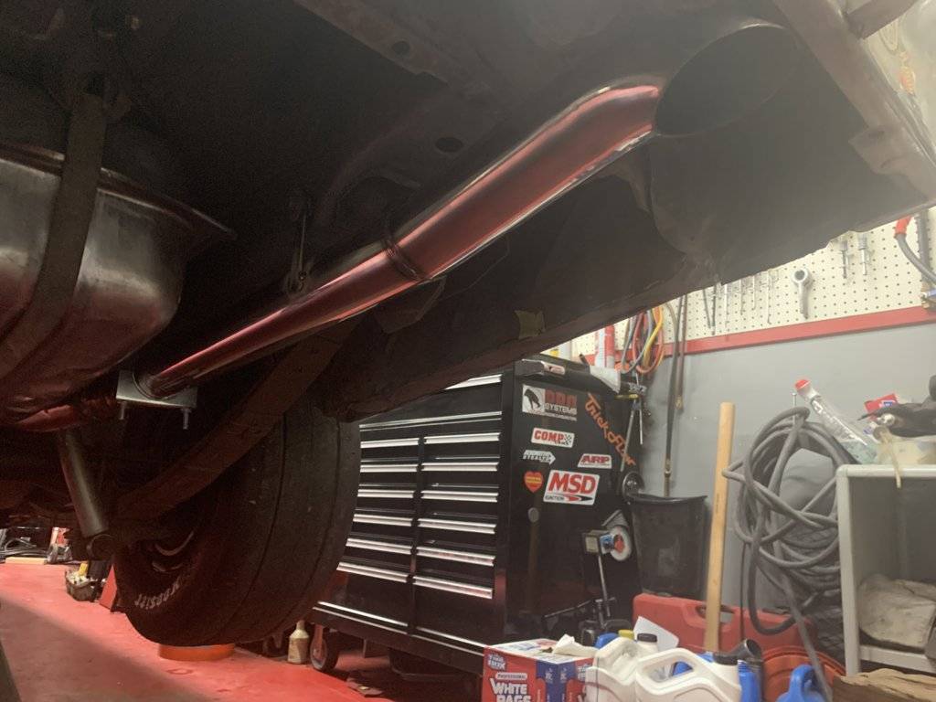

So I’ve been building up a 75 royal Monaco coupe. 400 now a 512. I went with the hooker headers for it and made my own 3” exhaust out of 2 stainless exhaust kits off eBay. Lots of work but doable on our boats. I can get some full photos later if you’d like to see as far as clearance and routing.

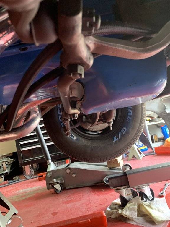

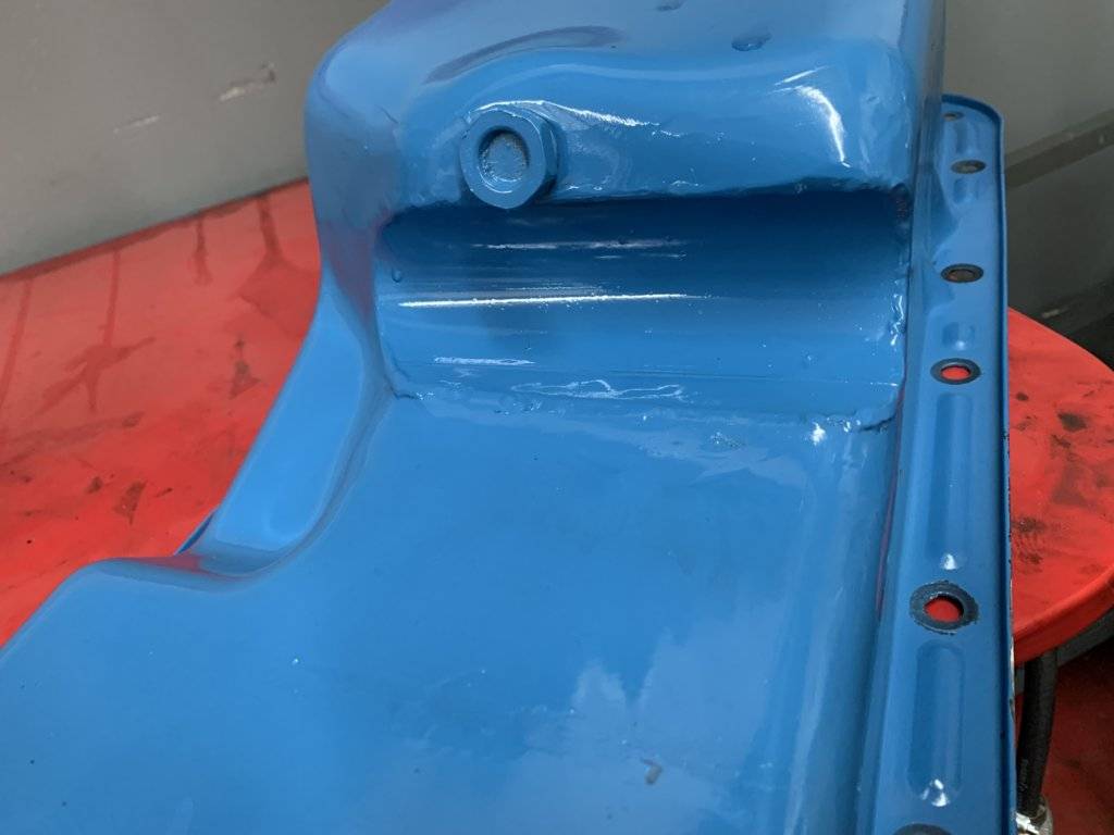

If any of you are interested in using the hooker headers for our model years there are some mods you need to make to the shifter linkage to clear the header. I can post some pics of all the gotchas I ran into building this thing. Also the 440 source 6 quart pan will not clear our center link without lots of modification. I made it work but not fun. Cars a blast though! Made 602hp and 707 torque.

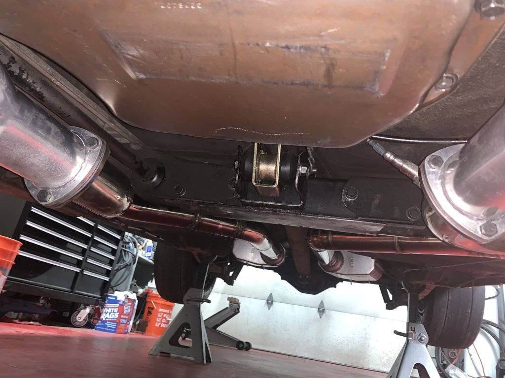

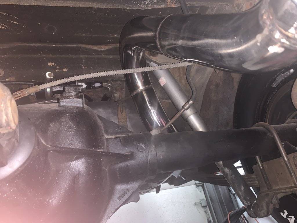

I asked TTI about that and the reason they don’t list it is they’ve never been able to get a 74+ to see if it fits. By building my own I believe the issue will be the routing over the rear axle. By the looks of their photos the shock location was shifted outward for our model years. Their routing is outside the rear shock. Only option for ours is inside.
Here’s a shot of my routing. If I did it again I would’ve bought a better quality tubing like stainless bro’s. The eBay stuff is okay but the thickness consistency of the bent tubing varies a bit so it’s easy to blow through with your tig if your humming along and then it all the sudden gets thinner. The stainless bro’s product is far superior.
