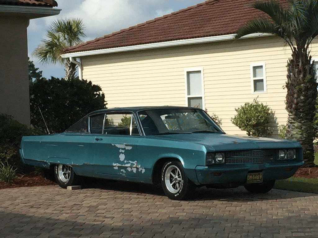

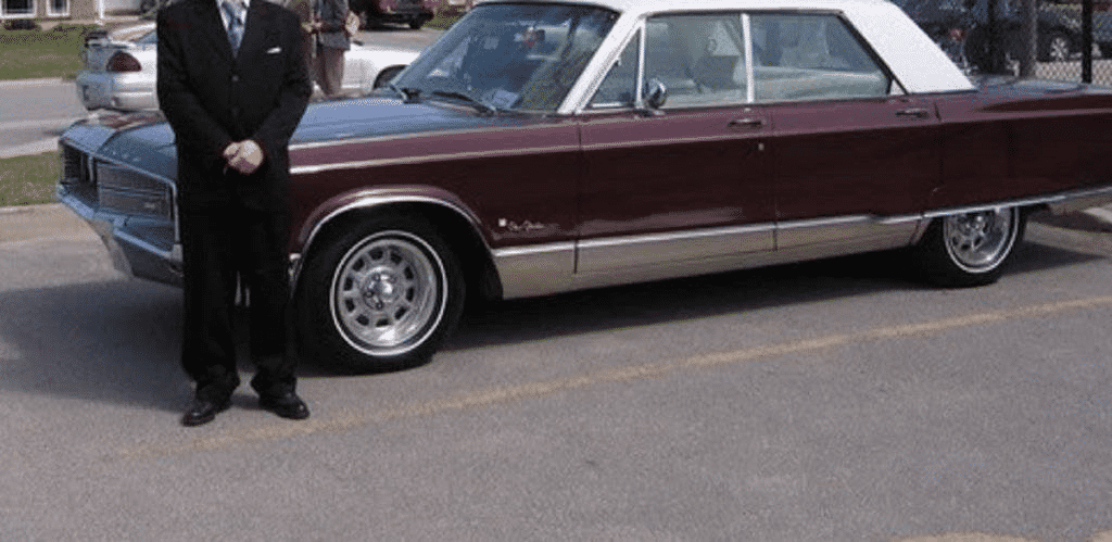

Not sure about the nubs, but the wheels fit nicely on my '65. Thats's where the wheel covers came from as well.

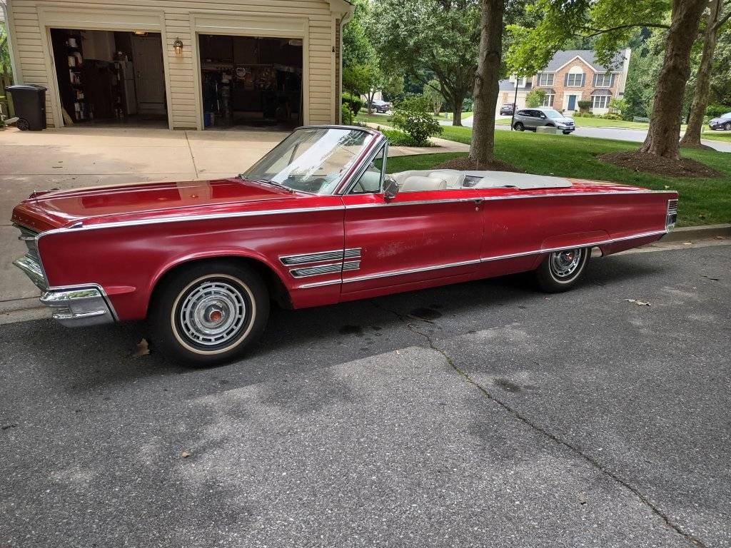

Here they are on my 66 300.

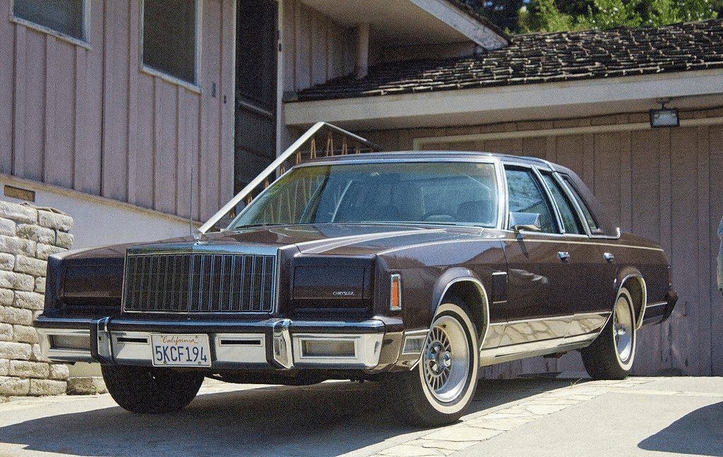

Second-gen Cordoba and Dodge Mirada alloy wheels work, too! Look good on the Slabs, too. Take the "5 + 5" spoke Cordoba wheels (about 1981 or so), machine out the smaller spokes, and you have an "alloy Magnum 500"-look wheel.

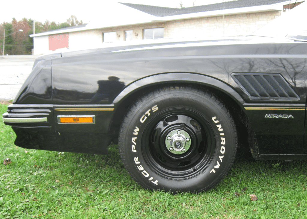

I have done this look below on 15x7, 5x4.5 M-body cop steelies .. right below are 1978 Magnum XE caps. The road wheel caps would bolt up fine too.
the very bottom set is the 15x7, 5x4.5, J-M-R stock, NON-police steel wheel. Many, if not all, '80-'89 civi steelies also have "ears" for poverty caps as well (check b/4 buying).
IF you want 15x7 "cop car" wheels, but without the hub cap nubs, think "1979 Magnum GT" wheels. Take a center cap and possibly trim rings. Same with the 15x8 "Kit Car" wheels, except the Magnum GT wheels have a special heavy metalflake coating over a black primer.
