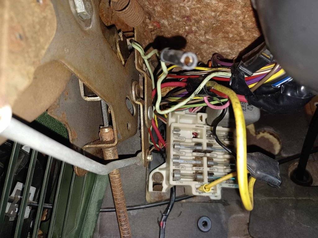

Bought my 70 Newport last fall, had it long enough to get her running with new carburetor and brakes and make a list of items to look into before storing it for the winter. Bigger issue was a lack of a working gas gauge, but the radio, odometer, and trip odometer weren't working either. On the gas gauge I found a few posts here about issues with the electrical being the cause, and with the radio not working too I figured that first chance I got I'd look into the electrical. Storage facility did the pick ups today, so I got her back out, did some cleaning and touch ups, and took a quick look at the fuse box. I seem to be missing a fuse for "Console," but its also missing a clamp on the right side?
Am I on a right track, that fuse impacts my gauges and radio and I am missing something here, or is that slot just not used on the 70 and I'm chasing a red herring?
I'm pretty sure that's empty unless your car has that option.

Speedometer is working fine (thankfully!), radio doesn't seem to have power period so I'll root around that. I DID see the grounding strap conversation about the fuel gauge so that was my next stop if the fuse box wasn't the case, so thanks for confirming the likelihood of that one :)
