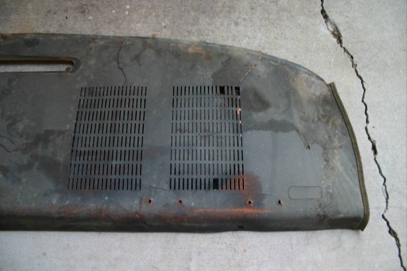

As far as mounting them there should be two dimples in the metal of the tray support where they would of mounted.
There is a knockout on the package try (at lest there is on a 69), seen in the lower right corner of this panel.
(the four screw holes are for the CHP lights and the wires ran through the enlarged hole in the lower part of the speaker.)

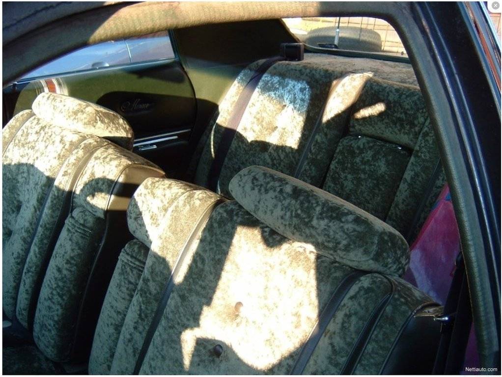

Is this original place for them? 1971 Monaco 4d.
Did you ever get an answer to your question? - I think the '71 Monaco rear seat there has aftermarket belts. If that car is "Suomi-auto" those belts might have been installed by the dealer - Aro-Yhtymä Oy - who installed many custom options to the Dodges they imported. It was more economical to import the cars as plane jane versions, and equip them here, as the car-tax was based on the price at port.
Aro-Yhtymä even went as far as importing base Aspens without upholstery, with only seat frames. Low car-tax -> lower selling price. They then built the interiors, including seat foams, here in Helsinki, and called the result "Aspen Special". The seats had firmer padding than in the US models, and the whole interior was wrapped up in velour.
