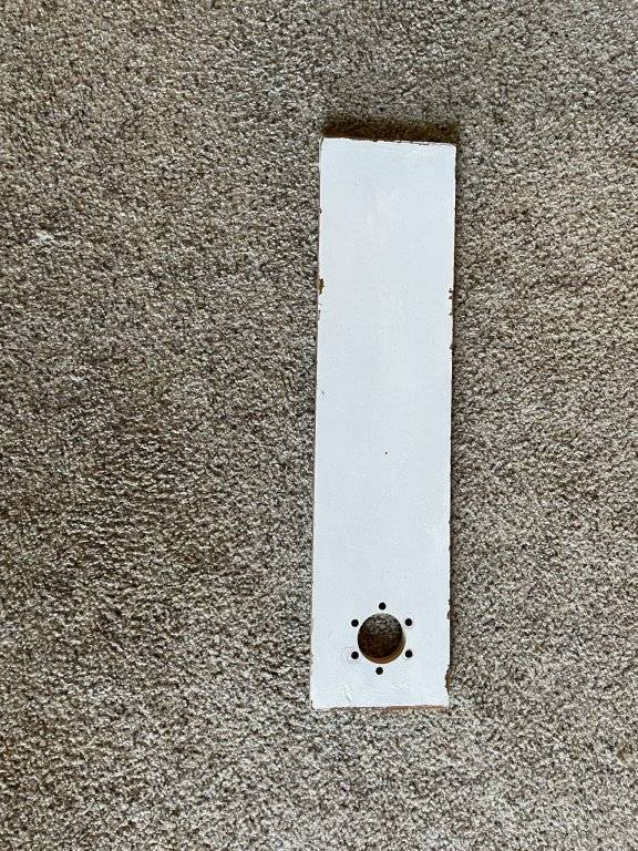

I presume you're referring to the bolt holding the harmonic balancer. To do that on my car that I made this holder out of a scrap piece of wood using the pulley as a template. I put 3 or 4 of the pulley bolts through it into the harmonic balancer, it wedged against the frame as I was tightening the harmonic balancer bolt. Worked great.
Hey Barry, thats a great idea! I looked after a way with the pulley installed but I start feeling I have to remove the pulley to get a hold on the bolt and tighten it.
