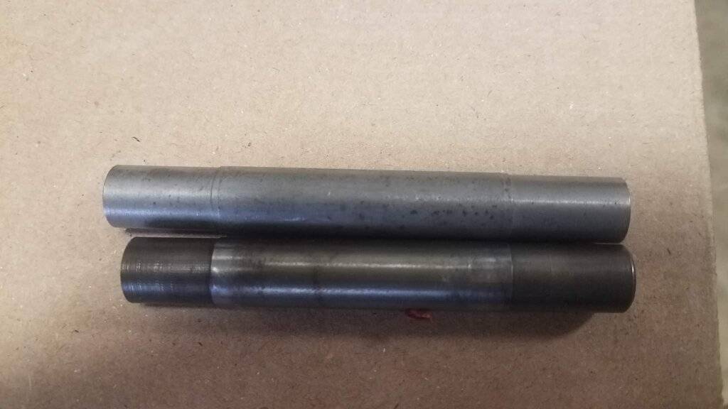

Putting my engine back together and my existing fuel pump pushrod is 3.190 and had no issues with fuel. I do have another one that I am not sure where it came from that is 3.25. I would rather stick with the existing one as I know it is hardened and good, just curious how short is considered too short? TIA

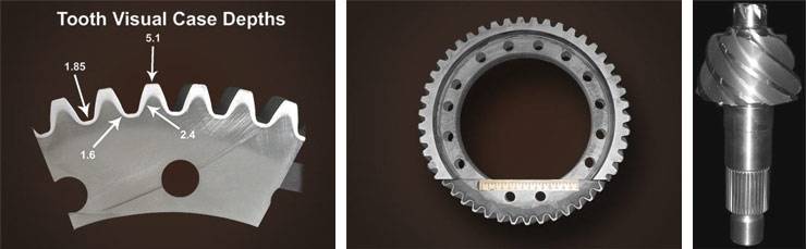

Depending on the material, and how it was hardened, just the surface of the pushrod could be hard and you might be down into where the material is starting to get soft. Might not be too... Got a Rockwell hardness tester in your garage? I don't either...
I have no idea of how the the push rods are hardened, or of what material they are made of, but it would not surprise me at all to find that they were not hardened all the way through. This illustration shows hardening depth on gears just to give an idea what I'm talking about.
