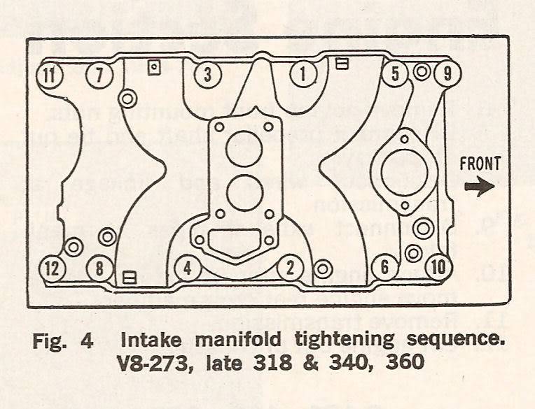

The torq specs and bolt down pattern for my cast 4 barrel/318 intake would great. I remember from the middle outwards is the norm. I don,t know if it makes any difference in specs but the motor is a 75. thanks and Merry Christmas
thanks for the link...all the so called free ones I found were not....It would almost definitely be in a late '70s service manual or the '75 manual if you have it.
If not:
http://www.mymopar.com/index.php?pid=109
Ref: Page 11-15 of the 1974 FSM.
318 & 360 Intake manifold torque specification 35 ft lbs. Tighten as per figure below:
