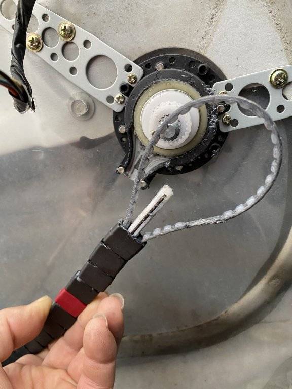

@Fishfan , the Amazon option is cheaper, several hundred worth. But according to the reviews, the "adapter" that connects to the crank stub is driven by a cogged cable/belt and can strip or even break. I'm thinking it could be due to stiff manual regulators binding.
Here's one such example:

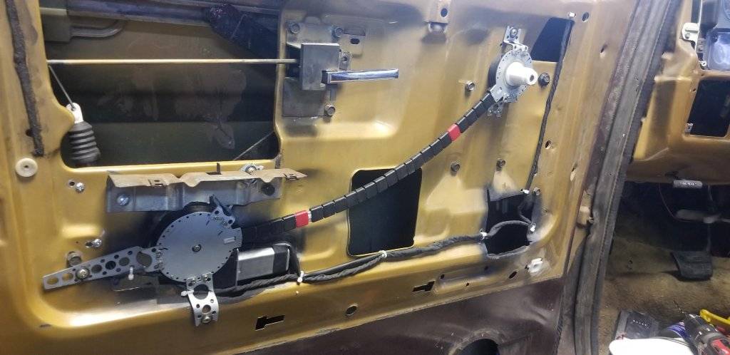

Here's a typical installation in a Chevy truck:
As you see, the crank drive is separate from the motor, allowing one to tuck it away in an open void or pocket of the door. The kit comes with a plug to hide the crank adapter in the door card crank hole, and an optional Tee handle to manually open or close the window in the event of motor/belt failure. My concern is if the door card would fit over the adapter without creating a bulge.
