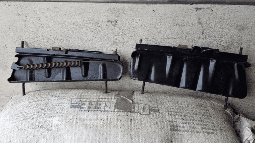

Never seen that someone did this at the seat brackets but i did it with a few c bodies......
In front and back of the bolt that is going through the floor there,s a hole , so the bolt in the middle is standard from the factory....
If you replace the bolt in the front hole you get 1 inch more leg-space....sounds not much but it helps......:)
Or you can buy the same thing in standard threads
5/16" by 1 1/2" long.
