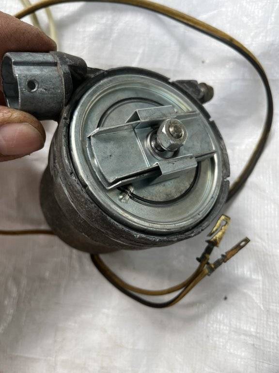

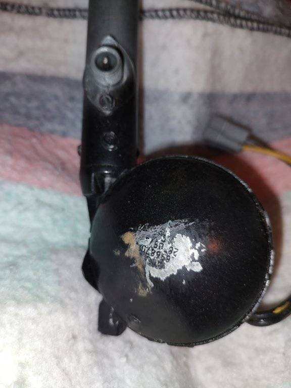

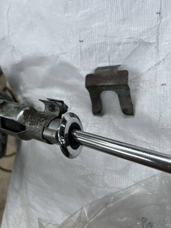

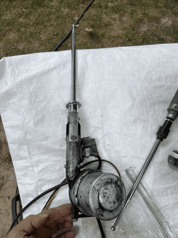

Here are some pics, the broken antenna is from a ‘73 New Yorker and the good one is from a ‘70 Newport, but I think they were all the same for C Bodies, ‘69-‘73.
Broken:
Note the string trimmer line:
Here is a complete one fully retracted:
Correct bezel and retainer:
Here it is in place on a ‘73 NYB:

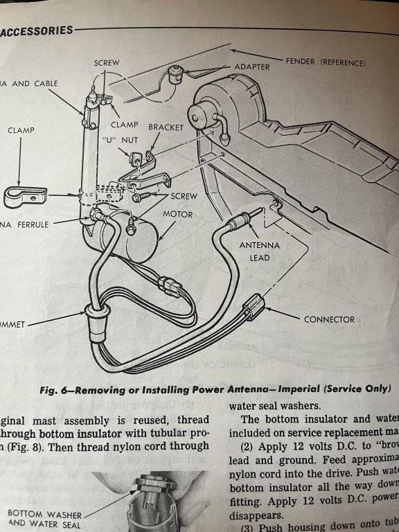

Here are the pics from the FSM showing the different tube lengths for Chrysler vs Imperial. There is even instructions on how to replace the mast, but like I said earlier, they are easy to break.

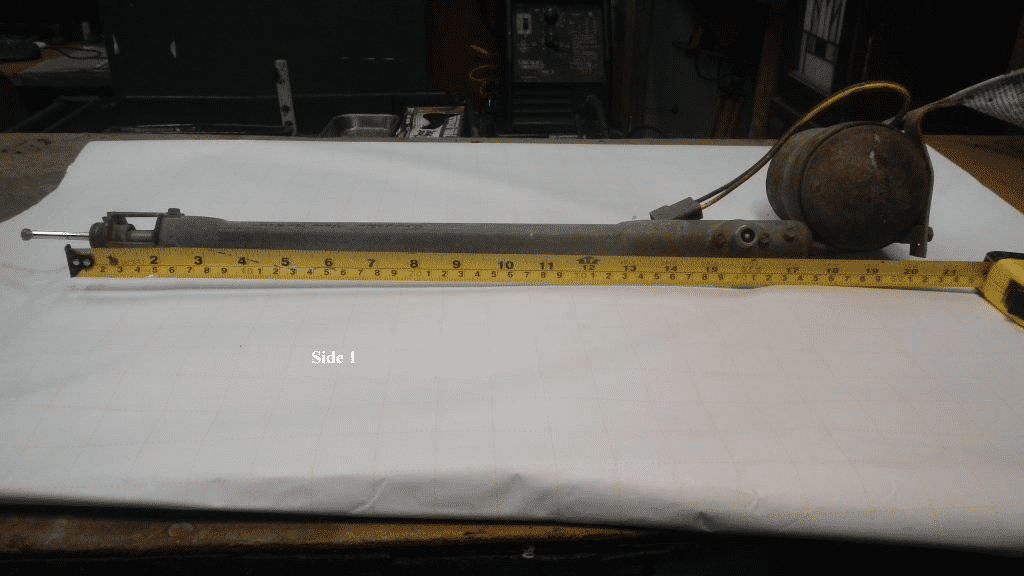

I have an NOS power antenna in the original box, part number is faded away. It's the long tube. I believe it's for 74, but not sure. I've listed it a couple Mopar websites. I'll find the pics and listing for you. 325.00.
I can measure the tube length for you if you want and send more pics of it. I paid like 375 for it a few years back, was searching for an NOS power antenna for my 65 300L, this was listed for a 65 but is completely wrong for my 65.
