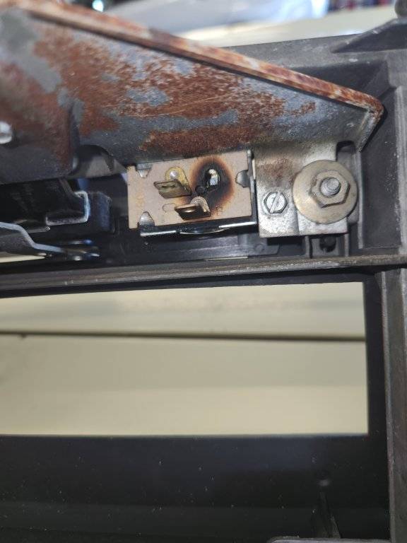

Biggest thing with r12 to 134a is do NOT FLUSH the a/c system, use 20% less 134a, look for major leaks from there and test for operation. It's just a slow process. My 73 new yorker I've found the blower switch fried when I pulled the cluster, along with other wiring issues and broken pins on the circuit board, hvac controls all the plastic broken apart, money's tight so I have to just wait.
