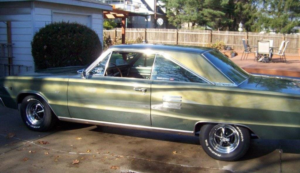

When I bought my coronet the PO had done a manual disc brake conversion and had the magnum rims installed. They fit fine but I don't know the width of rim and what vehicle he got the disc brakes off of. They are prob a 5.5" or 6" wide rim, when I replaced the tires the widest tire to safely install was a 235 /14. I do plan on one day replacing them with a 15" magnum, you are extremely limited on what sizes you can buy for a 14" rim anymore

View attachment 300926 When I bought my coronet the PO had done a manual disc brake conversion and had the magnum rims installed. They fit fine but I don't know the width of rim and what vehicle he got the disc brakes off of. They are prob a 5.5" or 6" wide rim, when I replaced the tires the widest tire to safely install was a 235 /14. I do plan on one day replacing them with a 15" magnum, you are extremely limited on what sizes you can buy for a 14" rim anymore
Most helpful as is Ross Woolridge below. Your wheels look good I would also like to go with the 15" but given that I just spent $1,200 on Coker Classics tires and I am satisfied to go with the 14" rims. My other concern is the Back Spacing. The hubcap spinner, stock 65 Sport Fury, on the rear wheels hit the fender skirts when I hit a dip and I am hoping I can correct this with the back spacing without creating a problem with the disc brakes
