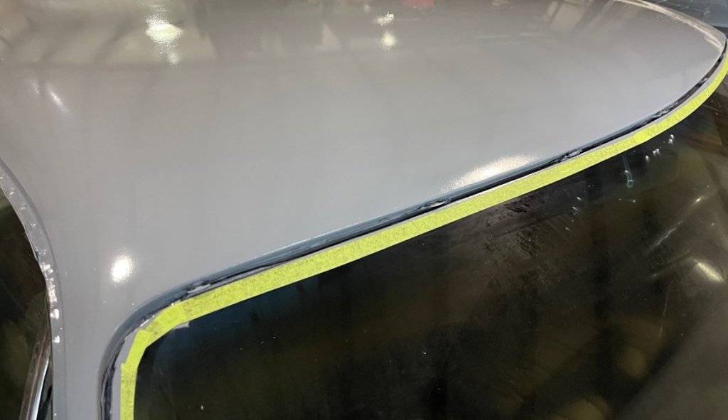

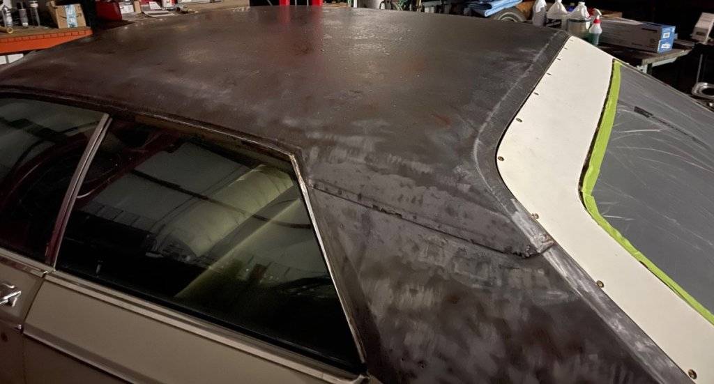

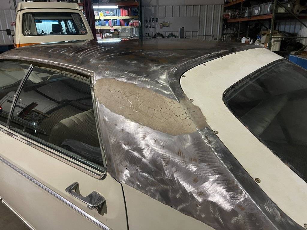

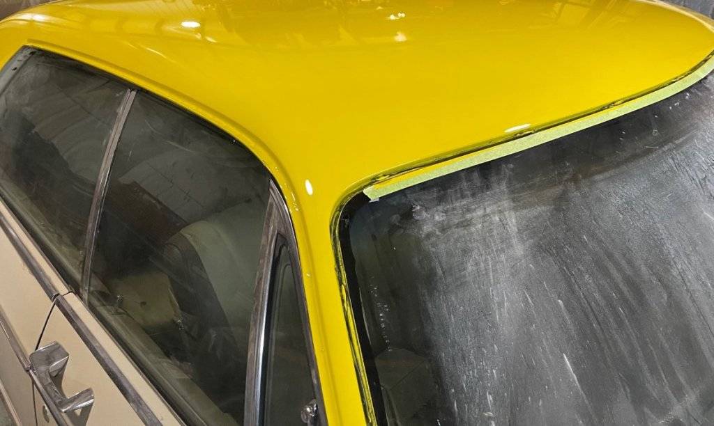

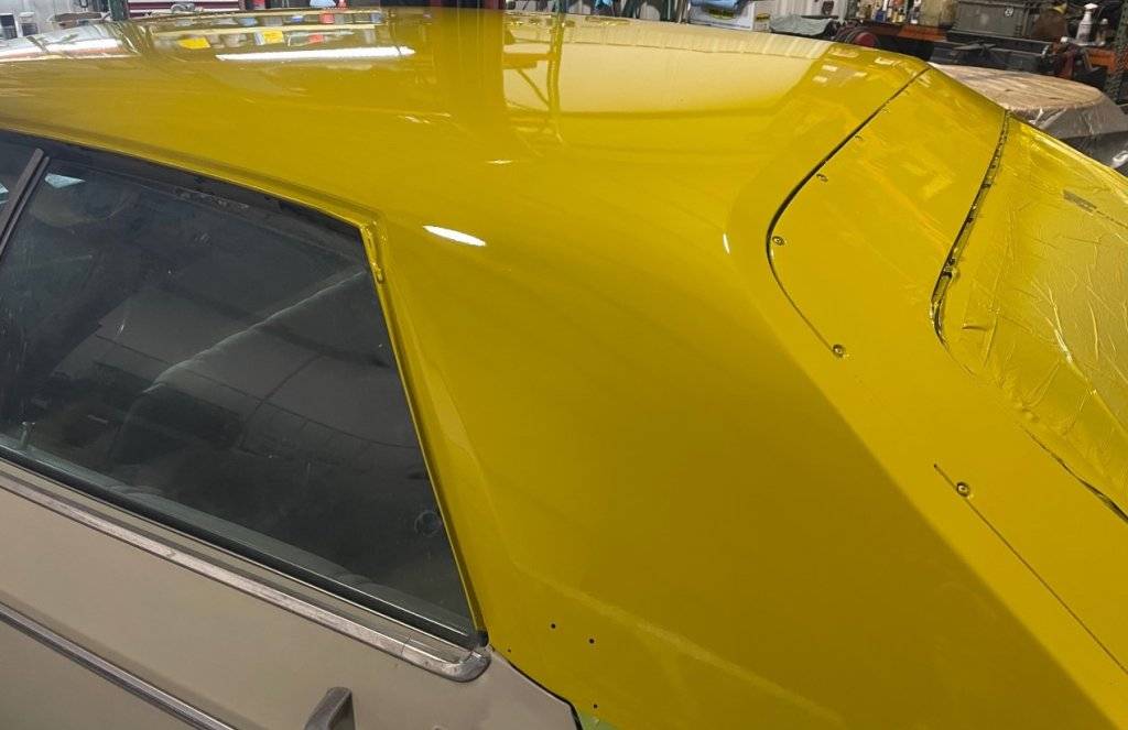

Hello everyone, Been a while since I have posted any updates on my car. Fortunately, I have some new info to share. Picture below with more details to follow soon.
Step 3: Rust Neutralizer

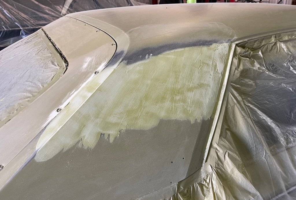

Step 4 Primer & New Roof Seam Filler

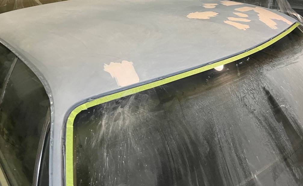

Step 5 Second Primer & Filler Sanding
Sand Primer & Spot Putty

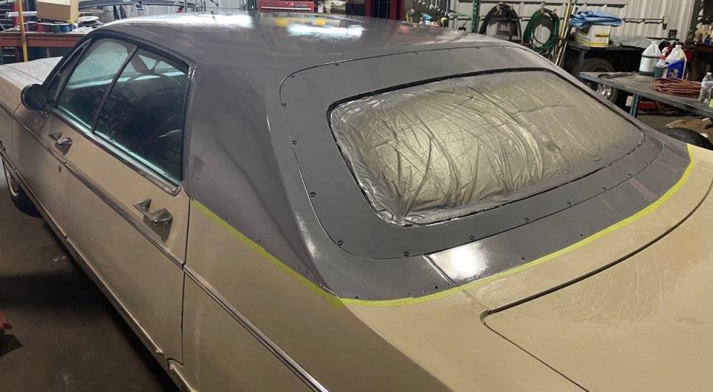

Step 6 Paint Top
Before anyone asks....... No, I am not painting it yellow, or turning it into a taxi (go broke buying gas). This was left over and I just wanted to seal and protect the top. This will be covered with a new walnut levant grain vinyl top soon. More to come!

What product did you use to fill the joint?

I believe it was a fiberglass filler.
