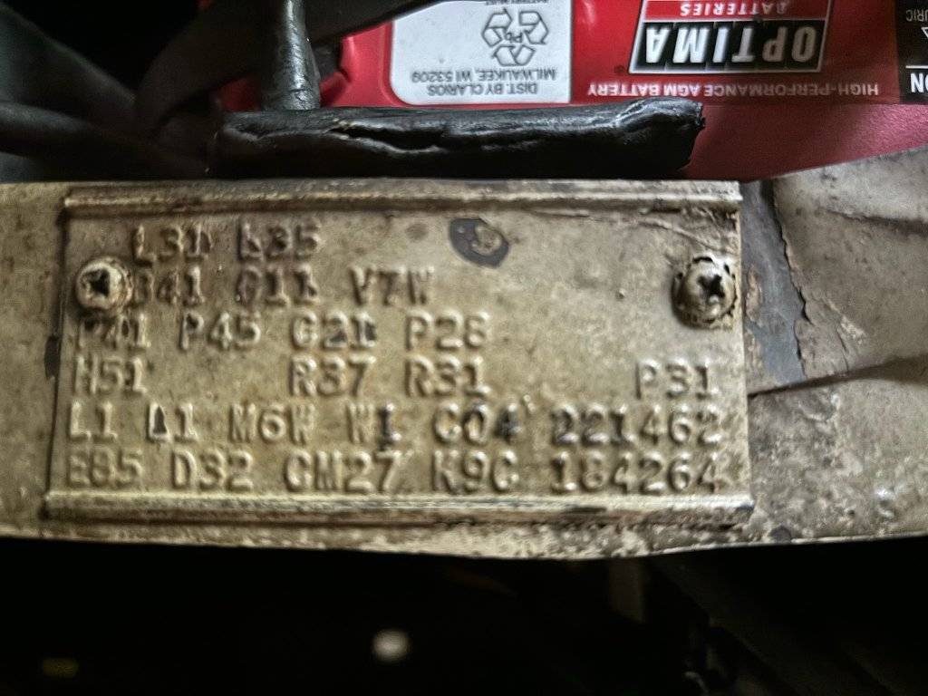

Purchased a 69 300 Convertible from NC. Not my first fuselage Mopar, but my first convertible. Needs this and that, but it's drivable. Nicely optioned. It does have cruise control but the online VIN decoder didn't list it - maybe out on that tag he didn't get in the shot. I look forward to reviewing the threads here.

Curious that is lists L1 - Cloth and Vinyl Bench, when clearly it has power (P28) bucket seats and center armrest...
Gotta love those on line decoders.....
K= 440-4bbl 350 horse.
L1= exterior color = Sandlewood. The Jefferson plant coded the paint twice regardless if the car was a convertible or not.
M6W = interior trim = medium level of trim; bucket seats; black and white interior
W1 = inner upper door trim is white
C04 = Scheduled production day = December (C) 4th (04). May or, likely, not be the actual production day.
H51 = a/c
C21 = fold down arm rest "buddy seat"
G11 = tinted glass - all windows
