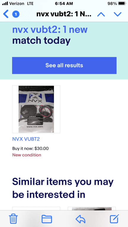

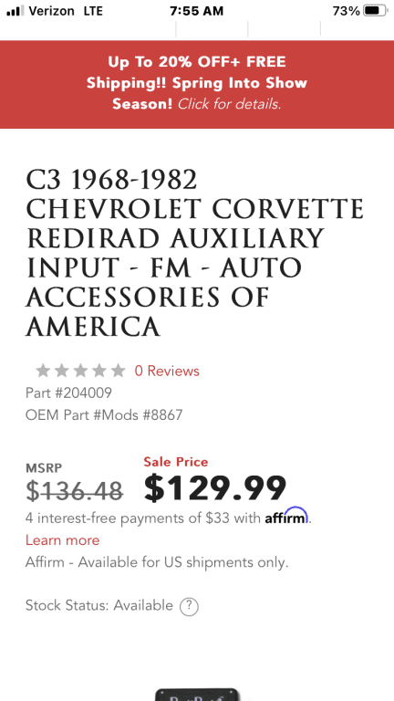

Search "Radio Adapter" on the forum. I converted my stock AM to an FM on my 65 SF with antenna adapter and then put in a bluetooth. I discussed at length. Questions, contact me. No Big deal and it works great! Takes two parts; one the FM adapter and then the bluetooth. Both easily purchased online. All for under $200 and you can do it by taking out your glove box and make the necessary connections quite easily.
On eBay. I put this blue tooth adapter and FM Adapter in my car, original radio and it works GREAT and overall reasonable cost. Both units difficult to find especially the adapter. Don’t let the fact that it on is Corvette Central, great company. Easy install through glove box. 1-2 hour project.
