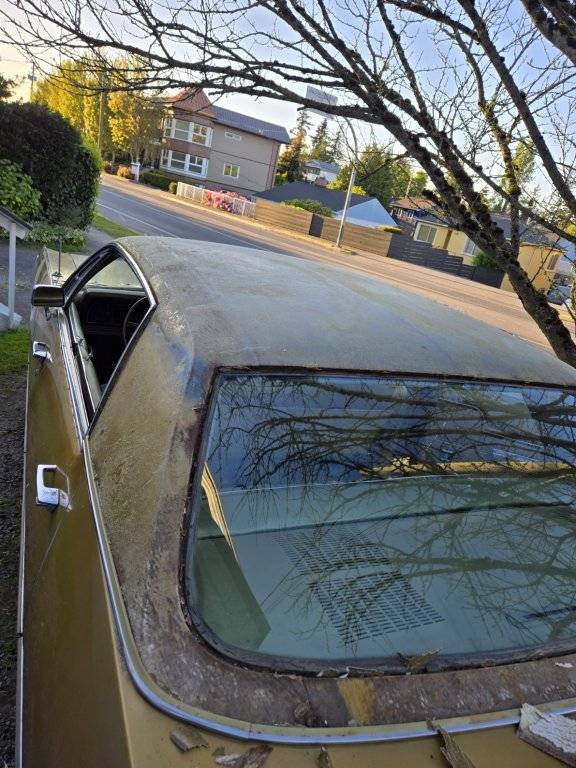

whats the best stuff to use to remove vinyl top residue from the exposed roof ?
(still have to remove edge trim)

heres the weird thing, the adhesive is still abit gummy............ the car was kept in a shed when not being used, the vinyl is brittle and has fine cracks in places it still came off in mainly 1 piece
