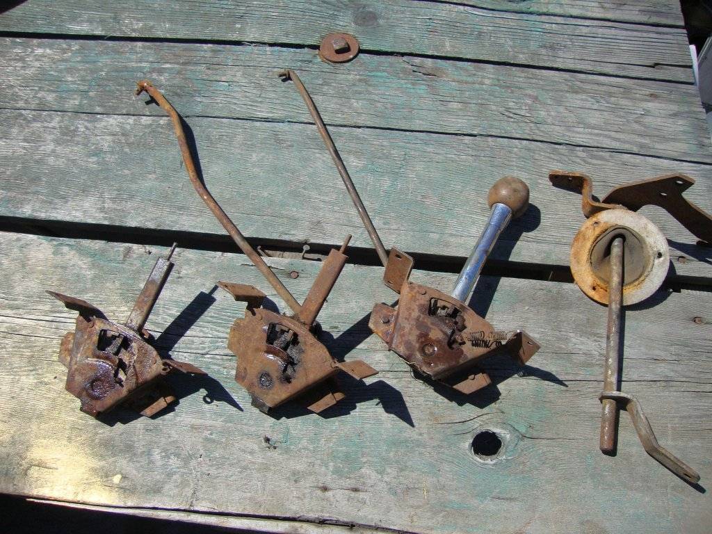

Oct 27, 2016 #3 pomonamissel Senior Member Joined Oct 20, 2016 Messages 3,408 Reaction score 2,562 Location san jose california well here is a pic of that slapshifter from the e/b body in the raw no tee handles or chrome collars , see what you think .
Oct 27, 2016 #4 twostick Senior Member Joined Dec 13, 2012 Messages 2,714 Reaction score 2,814 Location Beautiful Downtown Roebuck Ont. pomonamissel said: well here is a pic of that slapshifter from the e/b body in the raw no tee handles or chrome collars View attachment 98943 , see what you think . Click to expand... The shifter box itself looks the same between them all so it should be a simple matter to swap the straight handle for the C-body handle. Kevin
Oct 27, 2016 #5 pomonamissel Senior Member Joined Oct 20, 2016 Messages 3,408 Reaction score 2,562 Location san jose california maybe , but i've found desire can climb mountains . mounting bracket will be close .
Oct 27, 2016 #6 Big_John Illegitimi non carborundum FCBO Gold Member Joined May 21, 2013 Messages 21,844 Reaction score 33,098 Location Marcellus, NY We went through this before. I think the rod is shorter from the shifter to the pivot. The handle from a E-body will be too short to comfortably shift the car.
