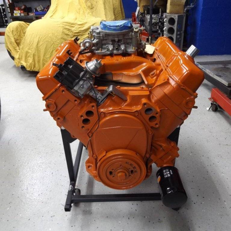

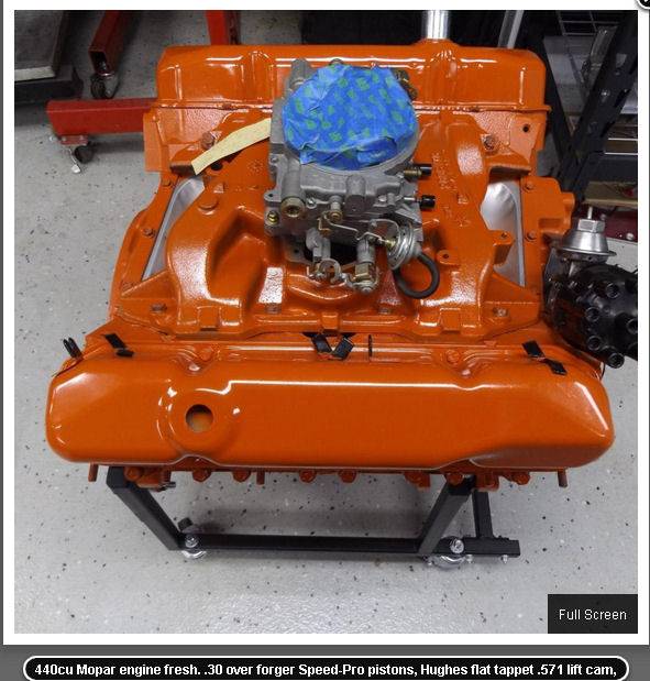

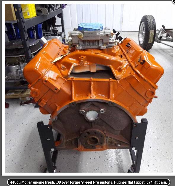

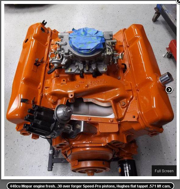

Thats when I discovered this for sale .....
Aarons Speed Shop USA had gone into liquidation = 50+ rebuilt motors for sale / ONE 440 !
So I bid and won it for $2k - imported it - going to change soon / keep
my matching #'s low. Just wondering if ya reckon i did OK ??? Cheers, Big Jim - DownUnder
You're concerned about putting miles on a Chrysler?? Put a roller timing chain in the orig motor and don't worry about it again. Normal maintenance and such will go well past 100K miles (US).
As far aw what you bought. Decent price. Too much cam and probably too much compression ratio for a street-driven car on "pump gas". IF it's cam specs are any indication. BUT, it's probably something you can de-tune as necessary without too much trouble.
