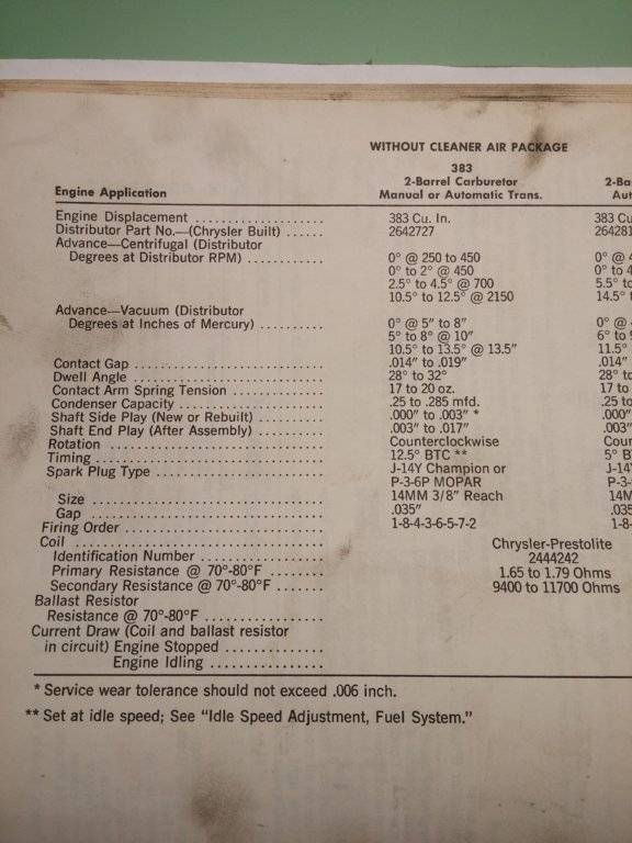

Here's what I got: 383 big block 9.2/1 Compression. 2bbl Stromberg WWC3 carb. Stock iron heads. Stock points distributor (see picture for timing and part number). Stock cam, Stock cast (single dual plane???) intake, Stock cast exhaust manifolds, Single exhaust pipe 1.5" diameter. Also this spring, I had my mechanic replace spark plugs, plug wires, new set of contacts, new coil, new condenser, set the dwell and all that.
From the manual it looks like I was into the mechanical while taking my measurements, oops. Just throwing some numbers here lets say we have 2 engines both set at 12.5* initial like the manual. Both are lightly accelerating up a hill in 3rd. I've got traffic behind me so I've got to speed up. For simplicity's sake lets say the 2 engines start at the same rpm say 2150. According to the manual, 2150rpm would bring mechanical to about 12.5* ontop of initial = 25*. From driving around with the gauge hooked to manifold I know that light acceleration, the vacuum is 10". For ported it might be higher say 15" due to the high load. According to the manual at 10" the vacuum should be around 8* and at 15" it's maxed at 13.5*
The manifold vacuum engine starts at 12.5+12.5+8= 33* but he still has to speed up to get away from traffic. The accelerator is pressed enriching the air fuel mix, manifold vacuum drops to below 5" (from tests), and the timing is retarded from 33 to 12.5+12.5+0= 25* and away he goes preventing detonation as he does.
The ported vacuum engine also starts at 33* but speeding up does nothing except go higher. All the settings are maxed out. "The rich air fuel mix burns faster" or so people say, and coupled with the high degree of timing, ping ping ping all the way home.
My problem with the ported vacuum setup is not only does it ping on hills but it also pings after every gear shift when the engine is suddenly loaded. Also from stop signs.

Thanks CBODY67! Will check those manifold bolts and I've never used octane booster. Only full tanks of 94 octane all summer and only started pinging after driving for 30 minutes or more (guess that's the warm up time). I read this on Thursday: http://moparconnectionmagazine.com/gallery-distributor-recurving-for-improved-fuel-economy/. Also I know you said base timing comes in at 1000 rpm but according to my service manual it says for the stock distributor, timing starts coming in at 450 rpm.
The guys in the website link I added were experiencing the same part throttle detonation like me. Sadly, they fail to state the octane rating of the fuel. They also fail to say if they're using ported or manifold vacuum to run the distributor. Anyways, they say "The advance was too abundant, and there was a persistent light-throttle rattle (detonation) at about 17” of vacuum." Their overall solution was to get rid of the "engine's 1970's emissions laden" components, delay the mechanical advance until 1750 rpm (up from 700 rpm) and reduce the vacuum advance rate using an allen wrench.
Before mods, they had 0* initial (for emissions) and 33* mechanical coming in at 700 up to 4000. After they had 15* initial and 18* mechanical coming in at 1750 up to 3000.
They state an average increase of 26% in fuel economy (16mpg compared to 21mpg) and an increase in horsepower of 15-20% all over the rpm range.
For my car I should stiffen up the springs to make it come in later, reduce travel in the slots to no go too high too soon and do something with the vacuum can to get my economy. I'm averaging between 9 and 10 mpg with my ported setup.
I'll let you know if I find a screw in my vac can.
In looking at theFSM page above, remember that the distributor runs at 1/2 crankshaft speed, hence the notation of "distributor degrees" in the spec. These are the numbers that you'd see if you put the removed distributor into a Sunn Distributor Machine to check its function. Our old Chrysler dealership had one and used it for EACH tune-up (they physically removed the distributor and put it onto that machine. Much better to set the points with and such, rather than leaning over a customer's fender!).
Notice too, the mechanical advance numbers. At total advance, there's 21-25 degrees "in the distributor". Add that to the initial 12.5 degrees BTDC and you get an "on the engine" advance of 33.5-37.5 degrees total advance "on the engine". That pretty much where it needs to be for best WOT power.
As for the vacuum advance, notice that it's "all in" at 13.5" Hg. Guess what? If the engine is working decently well, it's got more than that for intake manifold vacuum at cruise. So, no need to even entertain the idea of swapping the dist vac to "manifold" for better fuel economy.
