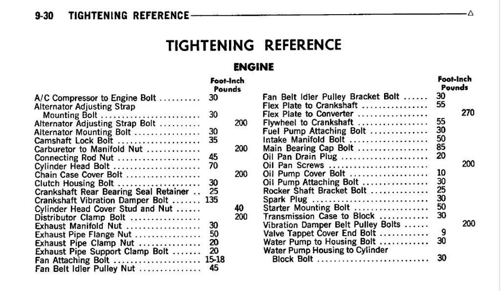

IMHO, I would use the torque wrench on the cam bolt at minimum. The crank bolt is tough to check torque, I just use my impact. Cover and water pump bolts aren't critical, just use some care to not over tighten.
