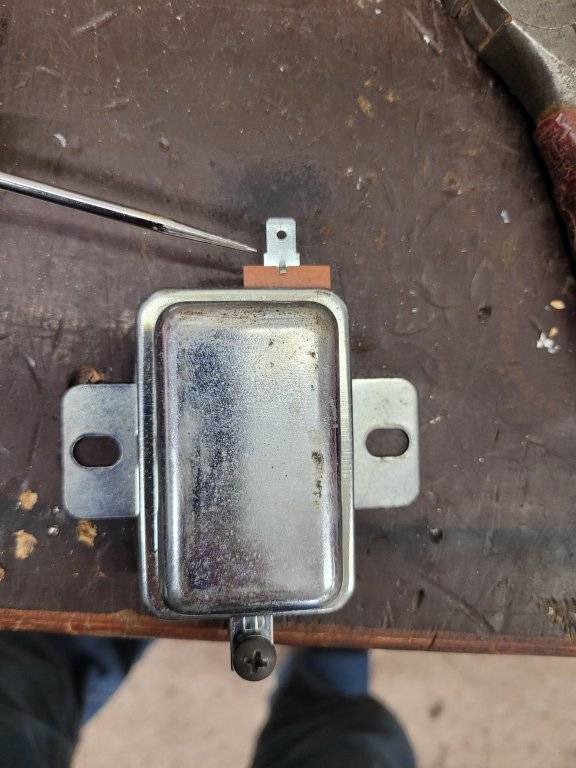

Apr 4, 2022 #1 jake Senior Member Joined Oct 23, 2012 Messages 1,537 Reaction score 1,079 Location wisconsin I apologize up front as I am slowly wiring my entire car. I just want to make sure that I am wiring this regulator correctly. Field from alternator to field post and other post to ignition? Grounding comes from the mounting brackets?
Apr 4, 2022 #2 B Bucket Member Joined Dec 10, 2020 Messages 111 Reaction score 37 Location Gympie Area , QLD,Australia Correct , make sure you scratch a bit of paint of the panel where the mounting brackets bolt to .
