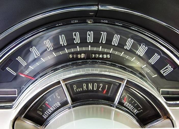

On 65 and 66 Chryslers, (don't know about others), the temperature idiot lights have a green"cold" light and a red "hot". On the bottom right of this pic (under 120) you can just see the green and red sections of the temp lights.

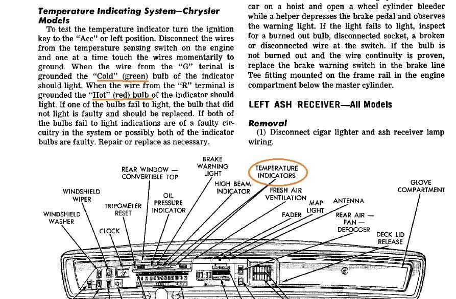

The cold light was related to setting the choke. Once the cold light went out you could kick the fast idle off and run normal choke. At least thats how I remember it.
I don't recall ever seeing one on any car. Anyone have an owners manual that mentions a cold light?
Most of the A, E, and B body cars as well as Dodge and Plymouth C body cars had temp guages. However it was common for Chryslers to have temp range lights.
Here's a pic of the features sheet that briefly mentions it:
Thankee kindlee John - that's exactly what I was trying to find. There are no real owner's manual indications because it's function is kind of self explanatory.
