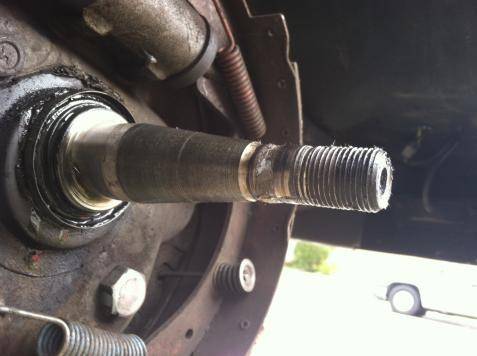

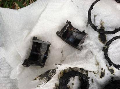

in this episode of welding with wheel bearings, we'll see a bearing race spending quality bonding time with a passenger spindle......
so - obviously dusted the spindle. it toasted the shoes and bent much of the brake hardware as well.
So question is i was thinking to upgrade to ECI or Scarebird disc swap kit - but i need at least one new spindle now also - is there a kit with disc spindles included somewhere and /or that have heavier duty spindles for beefier wheel bearings for instance - like the 73s (I think)????
does that make sense? or should i just source the same spindle I have now and do the drum kit upgrade?
email sent, thanks man
as option I am still curious what the 'upgrade' disc spindle would be and then what kit - am i correct thinking it is the 73?

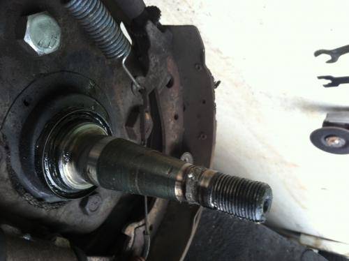

Clean it up (file the high spots)and put it back with new bearings and grease.
Those bearings lasted millions of miles in a lot of cars, just because some monkey put it back together wrong is no reason for a "upgrade" to larger bearings. They will do the same thing if not packed right and preloaded correctly.
i totally agree this failure was the cause of PO/PM - i shoulda gone through the fronts by now with other stuff that id seen - just didnt put 2's together soon enough!
My concern specifically with the spindle now is structural integrity since the pieces were hot enough to literally weld the race 3/4 around the shaft. Id hate for that spindle to crack under pressure down the road - im also running 18s - and discs would look a million times better so i can use this episode for the excuse.
the question really is - do i source the 65 spindle and do the disc upgrades available for those spindles instead of spending some dollars on new shoes, hardware kits and rotor or...
should I upgrade to a......????......spindle to get the larger bearings AND do that kit while im at it) lets face it - even though ma mopar no doubt engineered our barges braking components well, ability to upgrade to heavier duty stuff sits well with me
Sean
can someone confirm if 66 spindles are the same (interchangeable) as 65 (or what the difference is between the two years) haven't been able to find anything in search and Im able to buy 66 if they will work
thanks
