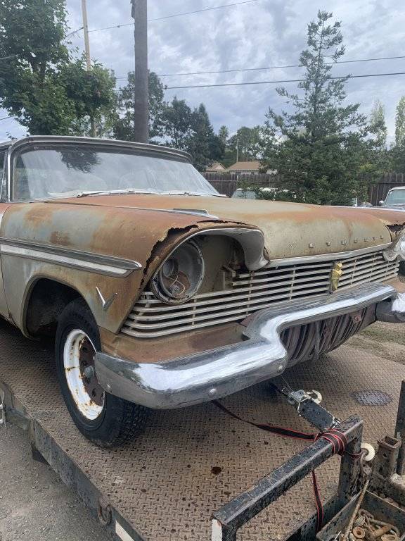

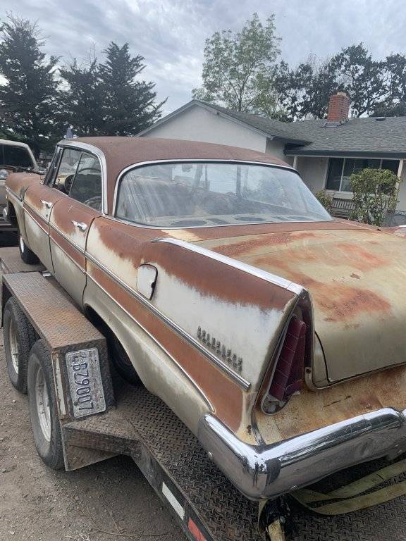

Rusty Muffler. I just got in a 57
Plymouth Belvedere 4dr for Parts.
I’m in Santa Rosa
If you need any parts PM me
Looks like it need the "eyebrow" repair panels I used to see in JCWhitney's catalog. Hope you primed and undercoated that area of the front fenders on your car, Rusty.
Looks like a really nice parts car!
