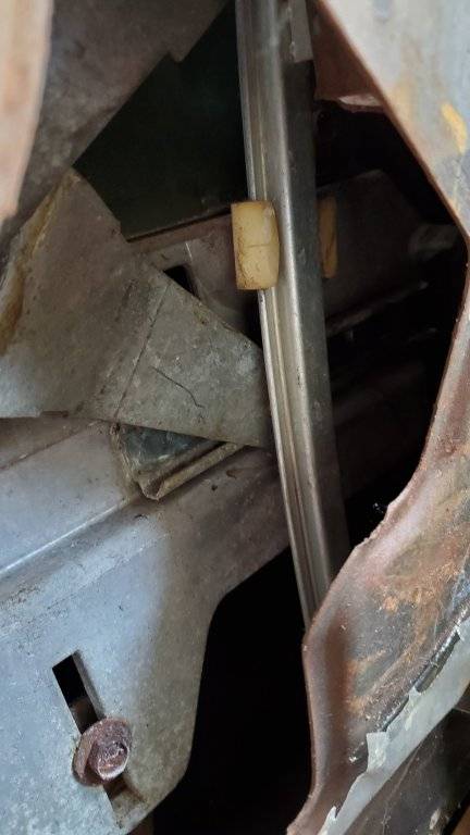

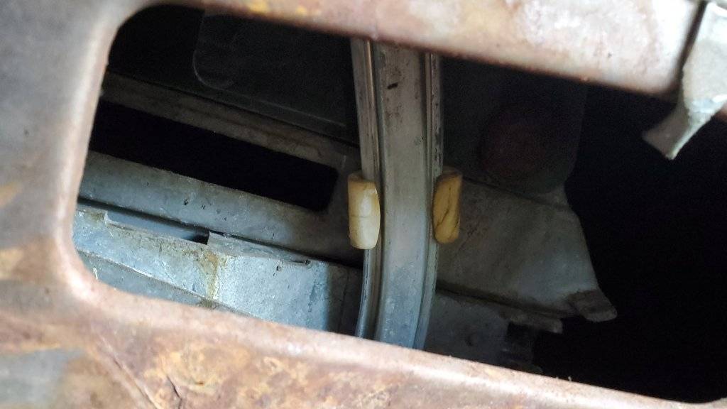

Car: 73 Newport 2dr HT. When I bought this car, the previous owner could not get the drivers side rear window to roll all the way up. It would go up, but was about 1/2 inch shy of coming forward. I thought maybe a track was out of adjustment, and just needed to be moved forward. Once I removed everything to gain access to the regulator, I see the window is designed to move back, as it moves down. The track for this window has a curve to it. I rolled the window down, then rolled back up to see what the issue was. I found a nylon guide that is designed to "guide" the window through the curve of the track is broken. The upper part of it is in tact, but the lower part is broken off. I searched the parts books I have and cannot find a breakdown of the rear window regulator for a 2 door car. At this point, the window is up, with a little help, and the handle has been removed, so it will not be rolled down in error. Does anyone have a diagram, and part number list for the rear window regulator on a 2 door model? Also will be looking for a source to the nylon guide.

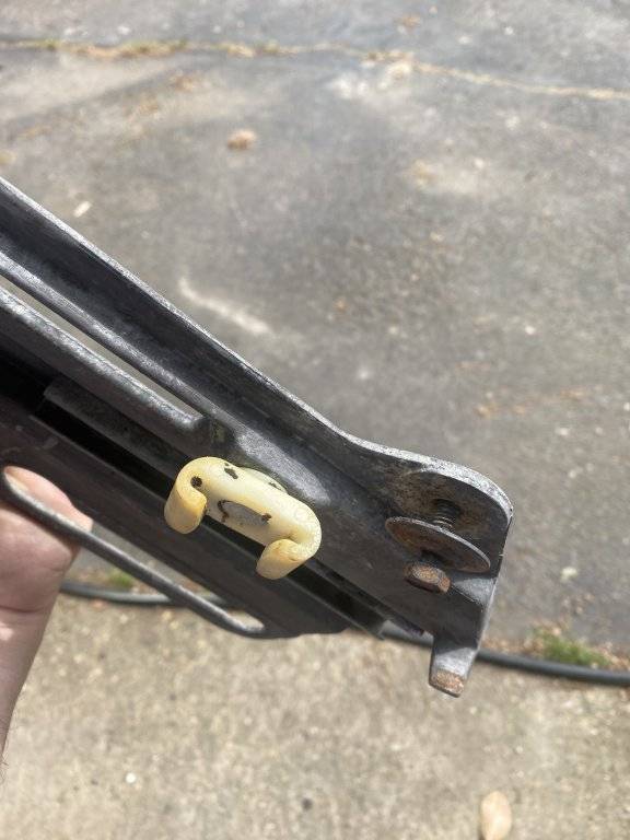

this is the guide from the other side (not broken). as you can see the track is curved. I could not get behind it to see the full guide without removing the assembly.

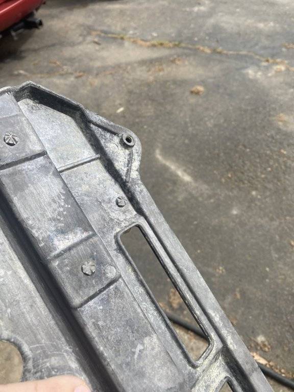

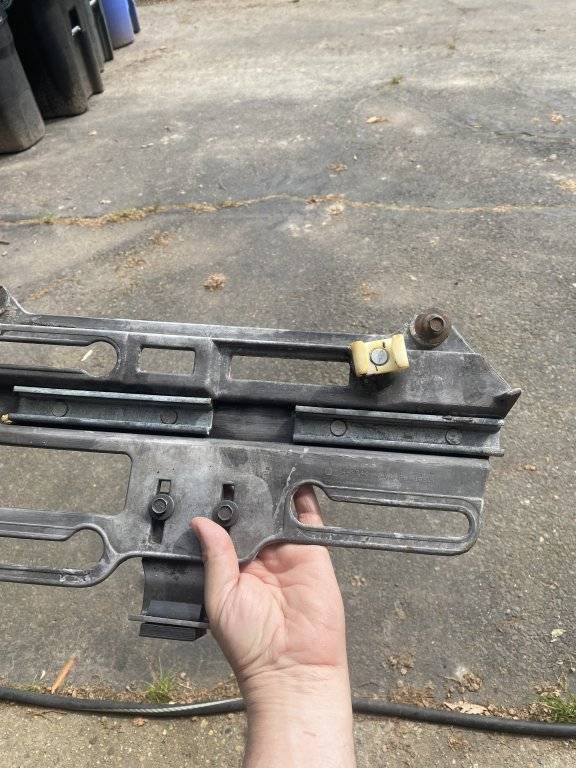

Not sure they make replacements for that nylon part. Here is a pic of the assembly. As you can see it is pressed into the assembly, not to say it couldn’t be drilled out and a new one retrofitted in.

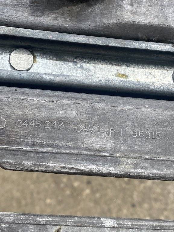

Here is the part number of the assembly, hope that helps.
Not sure they make replacements for that nylon part. Here is a pic of the assembly. As you can see it is pressed into the assembly, not to say it couldn’t be drilled out and a new one retrofitted in. View attachment 595745View attachment 595746View attachment 595747

3445242 is not in the 1973 part book but often #s on parts are not the # in the book
3454230 (QTY=4) is listed for C Bodies on the Qtr window regulator as "Bracket/roller and guide
Qtr window front track"

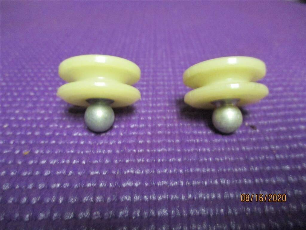

3454231 (Qty 4) QTR window front track roller guide pic off the web enclosed so that is not it

Thank you, but these won't work for the need. I will continue to search for the nylon replacement guide.

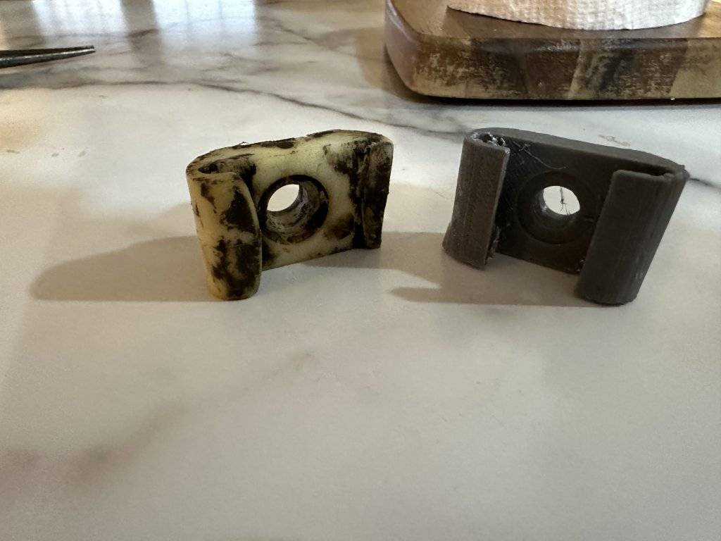

Those failed on a 73 I had years ago.
I used a piece cut from a lift track that the rollers ride in to lift the window.
About 2 inches long. Adjusted the gap to taste. Drilled the old out and bolted the new in. Worked well, no concessions.
3D printed. Mind you this is a test print with crappy plastic but the stronger stuff is en route
