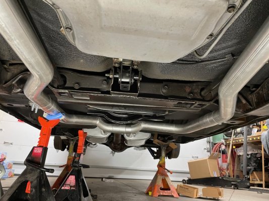

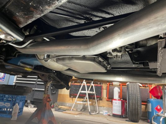

All installed, just tail pipe fitting.

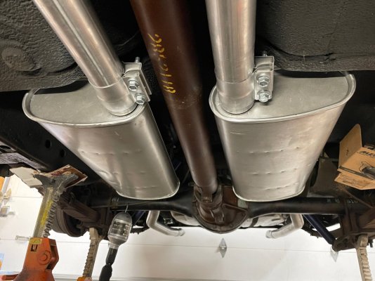

The TTI system looks great as usual, only a few things needed to fit the system to log manifolds in an Imperial. The right side head pipe flange needs to be re clocked to fit this year log manifold. second was just a shipping error when I received an incorrect head pipe for the left side and had to wait a while for new one to arrive. Mike at TTI took care of the problem immediately. Thanks. Third was that the system is designed for the Dynomax 25.5" mufflers and I had Imperial mufflers at 28", I had planned to shorten the mid pipes to fit but on these tail pipes they are bend at a 45deg and not a 90 deg out of the muffler. I got it all to fit nice with 3/4" at the closest area at front of muffler and foot well, shortened the tail pipe by 3"" and cut the muffler out pipe 3/4". This gave me enough slip into tail pipe to clamp or weld after I am satisfied with the hang.

Hi Boydsdodge,
can you tell me where you got those clamps, makes your work look really clean?
May be a silly question to you but did you weld the pipe under the clamps, looks like the clamps you used have a butyl lining inside?
