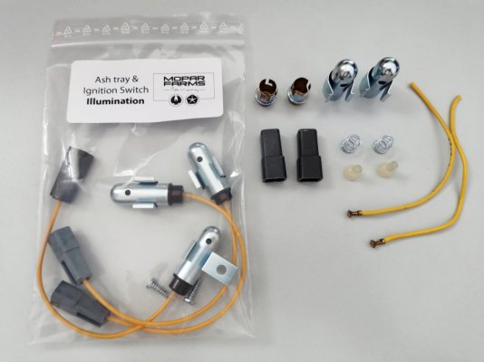

If your ignition key cylinder is like most 1969 Chrysler cars I've seen, the key cylinder is on the dash to the left of the steering column. So Plymouth fury has the ignition key light installed at the far left corner of the instrument cluster flood light panel.
With 1970 Plymouth Fury, the ignition key light stayed in the same place on the same timer, but the key cylinder was moved to the steering column. So with 1970 Plymouth it illuminates the switches, especially the headlight and interior light switches.

To my knowledge, there are no other interior lights to this style.

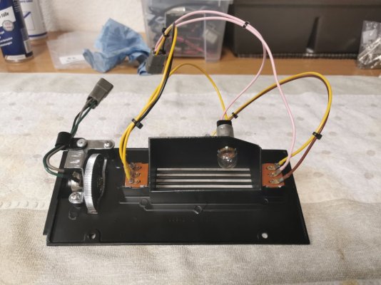

The only exception under the dash would be the map light, which has at least the same cable colors (Pink and Yellow) but has a different socket.
And that is a little bit weird because it's not grounded through the socket, means it's not mounted to metal.
* The Dome Light also has the same wire colors.
