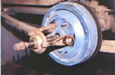

I m in the process of redoing the rear end, and the passenger side has been separated from the hub but the driver side is not. I am trying my best not to mess them up, but they are the factory drums with the factory shoes!! I have slowly been pulling the drum and hub off with atf/mineral spirits, but it is not going well, so just in case I do mess them up, I would love a second set.
Are you using a proper hub puller? Its the only way its going to happen.
Tighten it real hard, then take a heavy mallet and give it a good hard hit on the end and it will pop off, I dont think I have ever had one stay stuck, brute force and ignorance wins every time. :os_dancing2:
Ive been beating it with a 3lb maul!!!! It will come off but Im in no hurry, I have found out when I rush things I tend to screw **** up, so I m in no hurry, I have all winter. Thanks.
Unless you're doing a full resto I would dump that rear for a newer 8 3/4 rear end,,parts are cheap,,I also remember reading that you might be able to swap out your axles for a set from a newer rear,,,

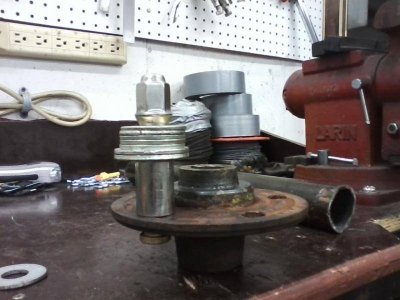

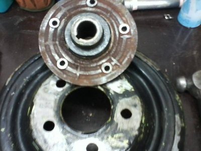

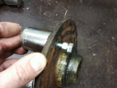

Got the drum off and will try pressing the hub out this coming weekend. Im on vacation over Christmas so I hope to pull the rear end out. I am trying to pick up a 741 chunk with 323 suregrip from a guy in the area, he wants 375, Iam hoping to get him down alittle lower. We shall see how it goes.

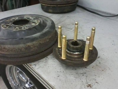

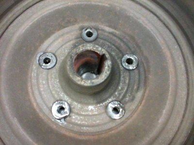

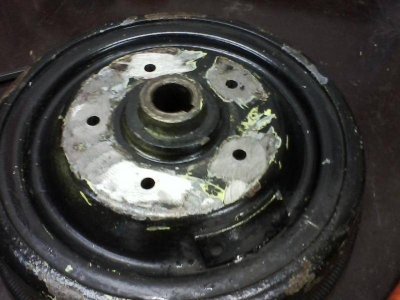

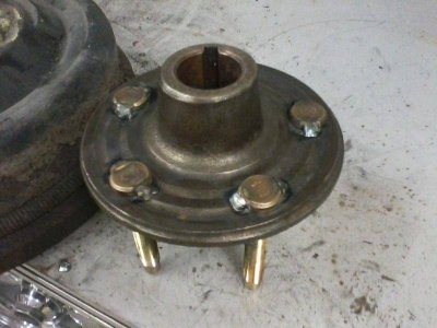

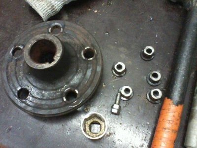

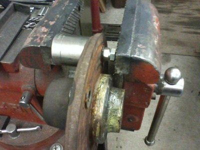

Well, today I separated my drum from my hub and pressed in new studs, everything went way too smooth. I managed to save the drum but the studs that people recommended from the internet were a touch too small. I order .625 because factory was .622, next time I will go a little bigger. I ended up spot welding the back of the studs just to be on the safe side.
