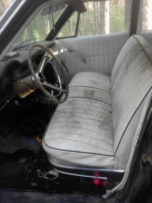

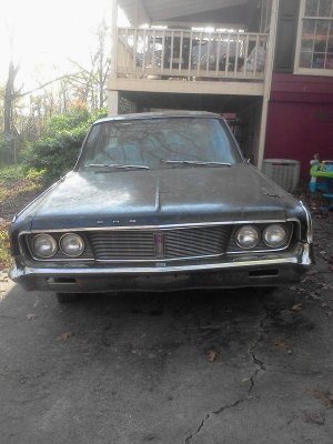

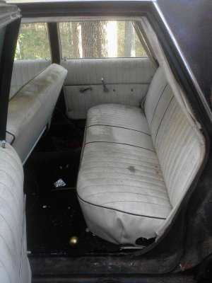

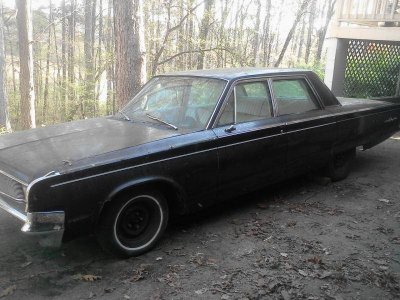

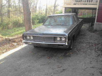

Hey guys, I have just recently bought a 65 Chrysler Newport 4 door with a numbers matching 2bbl 383/727. The body is in pretty great shape. It was sitting for five years when I got it. The interior is near mint condition from the seats, door panels, and headliner except for mold and mildew spots on the interior. It is pure White interior with black exterior. Still has original paint which isn't too bad. Only bad rust is the passenger front floor pan. Its a sexy four door Mopar. I bought it to turn into a driver because I have two small kids. I usually like to buy and sell/trade, but this car will be an awesome car I can take the family out in. I am not doing a full restoration. My question is, what is the best way to kill the mold inside the car? It is a pure white interior with the original black stitching on the seats. I'm worried that using bleach will be harmful to the 50 year old vinyl. I have heard that using water/vinegar solution and an abrasive brush will kill it followed by a leather cleaner and mold preventing solution. Does anyone have any ideas or tricks they have learned over the years that will work? I am wanting to pull the seats out this week and take off the door panels to kill the mold and clean the dirt. There is two windows that wont roll up, and the previous owner must have let it just sit there with the windows half down letting the rain pour inside. Its the passenger side windows ( makes since why the passenger floor pan needs replaced). People that leave their cars outside to rot just drives me crazy. That is why I am trying to save as many as I can before they all disappear. Thank you eveyone for any and all responses. I really appreciate it. Thanks-Jeremy newport interior.jpgnewport front drivers.jpgnewport drivers side.jpgnewport grille.jpgnewport interior 2.jpg

Use a 50/50 mix of water and rubbing alcohol to kill the mold/mildew. First thing is to use a mask! Use a shop vac with a the brush attachment to vacuum the interior after you remove the seats to get the loose stuff off. Be a good time to check for the build sheet under the back seat!! Then use the mixture to clean/kill the mold and mildew. Use a soft brush. Leave the seats and other interior parts after you clean them out in the sun to dry. Make sure you check under the seats too and the back sides of the other parts. After drying real good in the sun, treat with a good protectant. It worked great on my car as it was sitting outside for a year and got mold and mildew too. Now it's clean and no smell. If you can, let the interior parts sit outside or in a garage after drying in the sun for a few days before reinstalling. You can also use Febreze on the back side of the seats and let air out.

Thanks very much for that. I am going to try that, and I want to try the TornadorClean as well, but the alcohol/water mixture was another way I had heard and it was between that or the vinegar. I am going to try to alcohol. You guys on here are great. The interior and the numbers matching 383/727 are what sold me on this car. These cars look great as four doors. Since most people go after the 2 doors, the 4 doors are disappearing. I want my 4yr old daughter and 2yr old son to have some great memories in the back of this car, but if I do decide to sell, this will be the first place I post. I do hope to find the build sheet behind that drivers seat. It needs a trunk lock, back bumper, some windows on track, and then small things. C-body Bob had everything I needed a month ago, but I haven't had a chance to drive to NC yet. I hate to pay that much shipping for a five hour drive. I will post some after pictures.
Take the seats OUT to clean them!!! Carpeting should be replaced, as mold spores are exceptionally hard to remove from carpet. I'd strongly advise in favor of removing the headliner and the insulation, and replacing it with new. Door panels can be scrubbed with a soft bristle brush and a good tire cleaner such as Tire-Brite; along with warm water and dish soap, and they'll look like new. Just be careful not to soak the door panels, as you can risk damaging the door panel cardboard if you use too much water.
DON'T forget to clean under the dash board, the heater/AC vents/hoses, the glove box, and the defroster vents! You'll be amazed how much microscopic crap is in a moldy car.
Oh yes. The seats have to come out and the carpet is getting replaced. Yeah, it can hide and grow back in the smallest of places. The Headliner is in the greatest shape of any headliner I have ever seen in an old original car. I was going to take it out and replace all insulation underneath. I was going to clean the headliner because it has the least mold/mildew on it. If I should replace it I will, but that will really be a bummer because it is so perfect in condition. I would call it mint if it weren't for the mold. I don't even see them in as good of shape in new cars. 100% no sagging, no tears, nothing except the mold spots. Should I still replace it?
mine sat in a damp garage for about 20 years so i had the same problems. i used simple green and a tooth brush to clean my car, left the seats in the sun for a few days, no problems. the problems will be the smell from any soft trim items such as carpet and the burlap under the seats. the headliner is a pretty stiff material and should clean the same as the seats. i would avoid the tire cleaner as it might bleach the dark threads. also don't be too aggressive with the tooth brush on the threads as they will probably be in frail condition. even after all of that, i still had a smell i couldn't find. turns out the mold really liked the plastic of the steering wheel. i had take the wheel off and clean the back side to eliminate the smell.
I appreciate that. I was actually going to be going the toothbrush route. I was going to use the alcohol/water mix and a vinegar/water for the smell. I will check the simple green. I am definitely wanting to keep those black trim stitches in great shape. With the gloss black paint it is getting one day, and the white wall tires, the black stitching sets it off. I would like that Tornador Black. That video was impressive but the cheapest package I could find was $168. I want that in the tool box one day.
