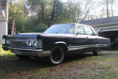

In early June I took a two hour drive with an older gentleman (Jim age 75) that I know to look at a couple of cars; ’67 Imperial 4 door sedan and a ’68 New Yorker 4 door sedan. Jim has restored many cars personally he owns a 34 Plymouth, a 47 Plymouth, and a 69 Roadrunner. When I was in my 20’s Jim was always willing to lend a hand with the 68 New Yorker that I had previously. he used to manage the parts room at one of the local Dodge garages for years. Anyway he came along because he likes to look at these old cars and is extremely knowledgeable. We had a great ride and a good time checking out the cars.
It was presented to me by the seller’s daughter that it was a package deal. By the time I spent about 2 hours looking them over and getting the engines to roll over we had come to an agreement for me to purchase both cars. The only disappointment of the evening was that the Imperial is so much nicer than the NYer, my personal preference. The Imperial is listed for sale if interested,http://www.forcbodiesonly.com/mopar-forum/showthread.php?20678-67-Imperial-4-Dr-Sedan.
She got the name the ugly duckling not because of her looks, but because of the weather the day we went to get the cars. It rained from the time we left, the whole time we loaded the cars, the drive home and much of the time while we unloaded them.
The Imperial was a breeze to load. Due to a broken relay to starter wire we winched it up on the trailer. The NYer we drove it up on one fuel bowl of gas at a time. For some reason the pump wasn’t drawing fuel that day, it works fine now. Due to all of the rain the ramps and trailer decks were soaked. At one point I spun the rear wheels and slide the car off the ramps and the left ramp came off and was under the rear wheel of the car. In an attempt to reposition the car to get the ramp out the exhaust was pulled loose.
Neither car had much in the line of brakes. I and the guy driving the truck that hauled the Imperial had to catch it to keep it from going off the front of the trailer. That makes you realize just how heavy these cars are, remember it was being winched not driven. The driving back with the cars was fairly uneventful except the guy in front of me that decided to stop short when coming up to some construction which caused me to brake real hard.

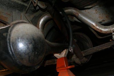

I already had the new Ni-Copp lines run across the rear axle so I put the rubber brake line on the back and ran the new line from the distribution block back to the line. I ended up buying some of the ridiculously priced factory line clips so that I could get it tucked up where it's supposed to be, looks nice. Then I put the new Ni-Copp lines in for the front wheels. I ended up pulling the backing plate on the passenger side front so that I could change the wheel cylinder. I'm going to pull the drivers side tomorrow and take them to work on Monday and run them through the blast cabinet over lunch. I wouldn't have done this, but since I have to take them off to swap that wheel cylinders out why not.

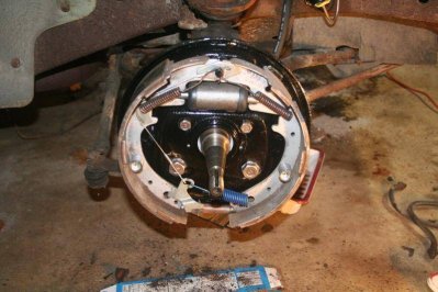

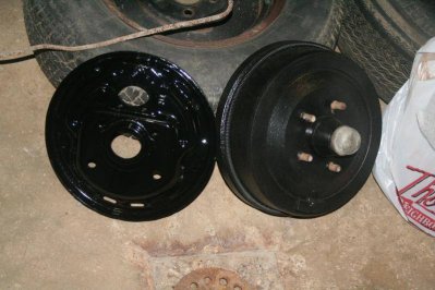

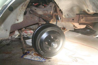

Even though it was chilly I managed to have a productive afternoon. With the new spindle seals in hand from DMT, a perfect fit by the way; I reinstalled the backing plates with the new seals and hoses already mounted in them. The larger bolts on the bottom were a bit of a bear to get lined up and through the holes. I put a little never seize on the shoulders so that if I have to take them out later on for something they should come out a little easier. Then I set the bearings aside soaking so that I could repack them.
The powder coated backing plate sitting beside the drum that was painted with high temp engine paint.

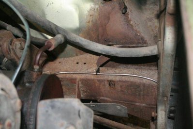

Two different shots of the Ni-Copp line running across the from sub-frame. Really easy to work with, but when you're installing it you have to be careful not to accidentally bend it.

I had already cleaned up the self adjusters, adjuster actuator, the oval washer from the top, and the little pieces that go in the wheel cylinders, so with new spring kits in hand the brakes went together pretty quick. Speaking of spring kits I was checking with the local parts stores; two regional chains and a NAPA, they didn't have them, but Advance Auto got the for me the next day. Man I slipped putting the driver side together and rammed the back of my hand into the spindle. Don’t do that it hurts, a lot. Especially when you do it two times in a row. With all of that done I repacked the bearings and put the drums on.

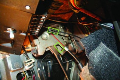

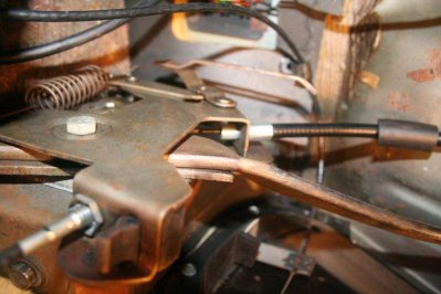

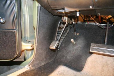

Last night was a good night. I put the front parking brake cable in. I was dreading this job after the fidgeting that it required to get the old one out. It went in with great ease, Praise Jesus! Literally the hardest part was feeding the cable down through the floor.
I’ll put some pictures below, but this is basically how I put it in. Once the cable was down through the floor I placed the end of the cable against the pedal assemble. Then from underneath I pushed up some extra cable; too much initially of course. While fishing around trying to figure out where the end of the cable was I discovered that “bracket” that the end of the cable mounts in pivots. This was a wonderful discovery. So I slipped a little bit of the cable back down into the housing until the end was beside the “bracket”. The barrel slipped right into the “bracket”. I almost fainted it was so easy.
The bottom box is the small space that you can slip a pair of needle nose pliers through when you’re getting the old one out or adjusting the amount of cable you have topside when installing the new cable.
The top box is the “bracket” that the cable end goes in. It is swung up toward the bottom of the dash in this picture. When the cable is in it pivots down and is inline with the end of the cable (the red line).

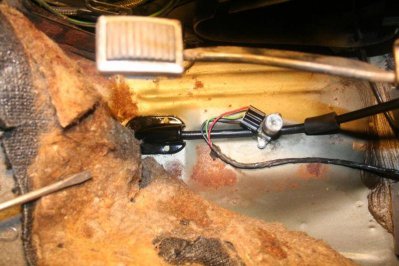

Below are some pictures of putting the inside back together.

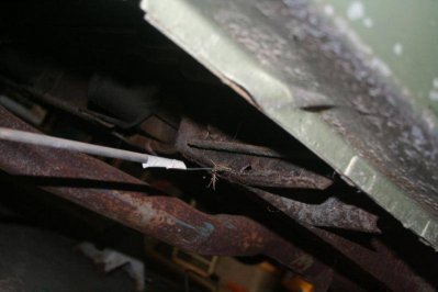

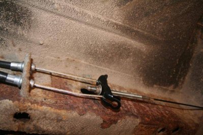

Here are some pictures I took while underneath at the backside.
An observation about the parking brake cables. The two rear ones were Dorman and the front was a Raybestos. As you can see in the picture the clip doesn't hold them perfectly tight in the bracket, but tight enough to do the job. The front the metal cable actually had some kind of coating on it to prevent it from rusting. If I would've know this I may have bought Raybestos ones for the rear too.

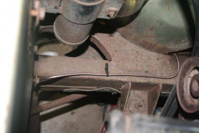

Ni-Copp line was a dream to bend and run. I was shocked how easy it was to install the front to rear line.
The original line running to the passenger side rear was missing so I had to make an educated guess as to where it should be run. Was my guess right? Over the pumpkin and across the back side of the axle.

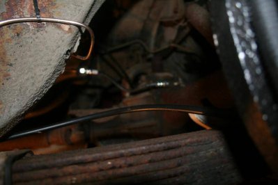

I also removed the fuel line front to rear. There was about a 2” piece of hose right behind the stub frame, is this typical? I’m considering trying to run the line as one piece. When I removed the font line from the stub frame I taped a piece of “mechanics wire” to it so that I can tape it to the new one and pull it through. The line is fastened to the frame where it comes out on the front side. The clamp wasn’t visible from the top.
I've pulled enough wires through walls that I figured if a fish tape will work in a wall why wouldn't a piece of wire work for this. We will see when I go to install the new line.
