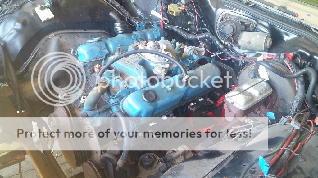

Finished pulling everything off the 360. Even have the mounts loose. Shes ready to come out.
