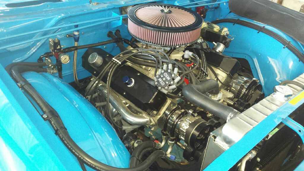

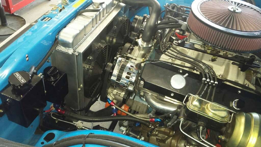

Very nice '66. I like the build. What did you use for the power booster and master?
SSBC front brakes the booster and M/C came from Summit it's a double diaphragm one with an extra vacuum storage tank, can get the model details if you want? The rears are standard GM type on the Moser Dana 60 setup.
Yes. The one you bought from Summit. Summit is telling me nothing is made for this '65 w/factory PB. Any help would be appreciated. Thanks

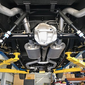

Beautiful Car and excellent build. What did you use for sub connectors? I've been looking for some to fit my 66 fury.
We made them ourselves used 1" x 3" heavy RHS they're removable and I can try for a few better shots so you could copy them. Certainly stiffen the car up a bit
Cannot find the receipt for the booster, we have kept the m/cyl and brackets but swapped out the booster to a larger twin diaphragm model (Chev I think?) the setup needed some mods to bolt up and I am pretty sure we just grabbed something to suit a mid 60's Mopar and went from there.
