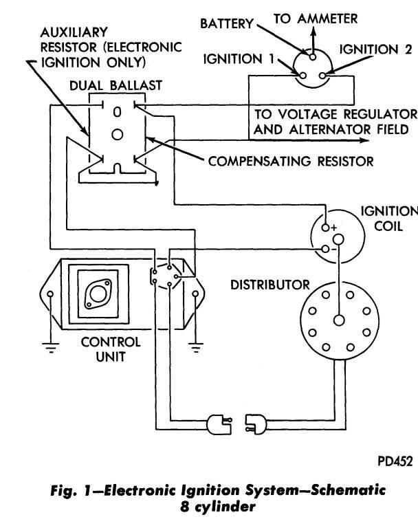

Thinking about this, you are getting current at the coil when cranking, so that would tell me that the ballast and ignition switch are good. The other thing that needs current is the ECU and that gets power through the ballast resistor if it's an older 5 pin ECU.
So, if you took the plug off the ECU, is there 4 pins or 5? The 4 pins ECU is plug and play and will also eliminate the need for the dual ballast resistor.
If it is a 5 pin, I'm wondering if there is an issue with the wiring/plug on the ECU. The thing to do is look at the wiring off the ballast first.

The ECU is a brand new 4-pin. It does seem like it’s gotta be a voltage interruption to the ECU, somehow. I’m studying the FSM wiring diagrams right now. This is so weird. I just tried starting it, seven times in a row, one right after the other. The first five, it started as I was turning the key back to “run” the sixth time, it fired up in “crank” and the seventh time, it again didn’t fire until I was turning the key back to “run”. Had +12v to the coil, every time.
*edit* after studying the FSM, I think the likely culprit is high resistance in the bulkhead connector, alright. Specifically, pin 12, which eventually feeds the ECU, in “crank”. I also see where it will backfeed power to the ECU in “run”, from the coil, through the ballast resistor.
“Edit 2* thinking about it, it can be that it’s backfeeding through the coil, or it would fire up every time. The backfeed must be elsewhere. But I’m gonna do some more testing later, to see if full-time power to the ECU makes a difference, and go from there.

Thanks for your input. I think maybe I’ve fixed it (shouldn’t have said that, lol) @Big_John suggested bulkhead connections and after studying the wiring diagram, I targeted pin 12 as the likely suspect. Sure enough, it had green corrosion on it (the only one). I cleaned it and so far, so good!
