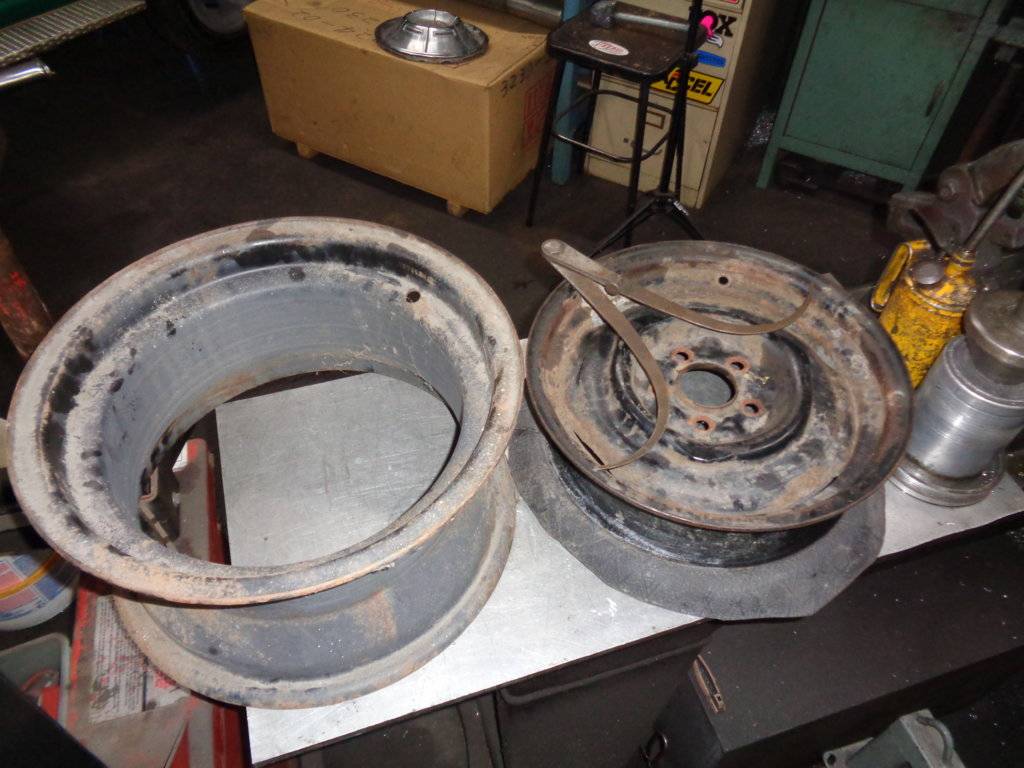

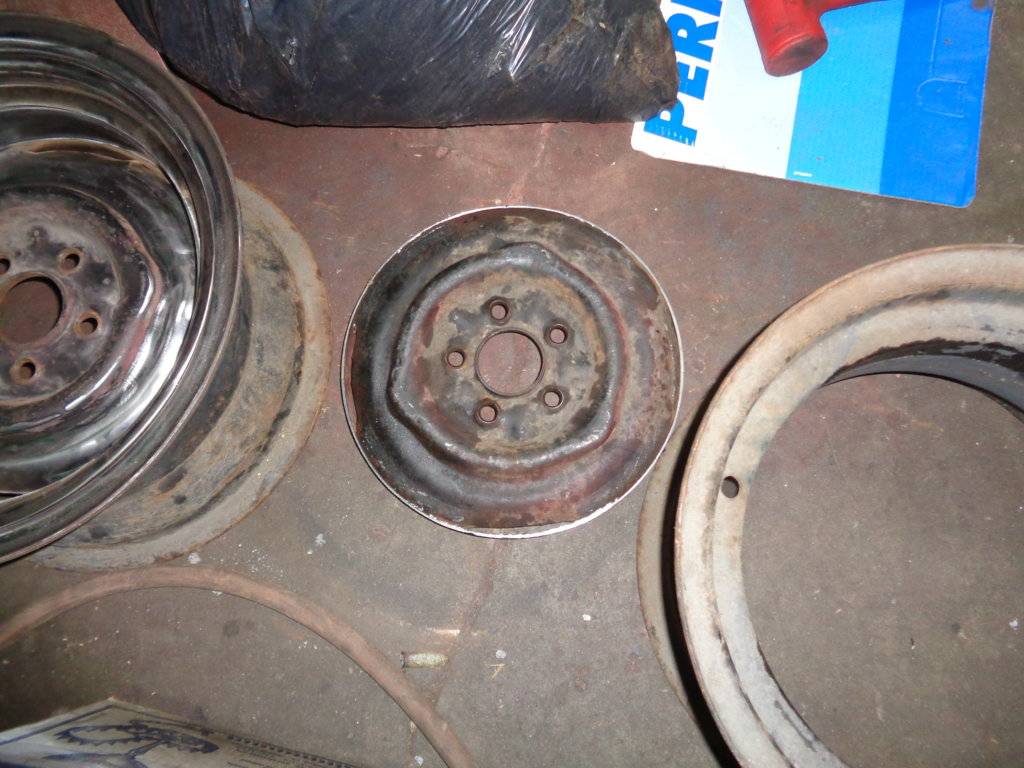

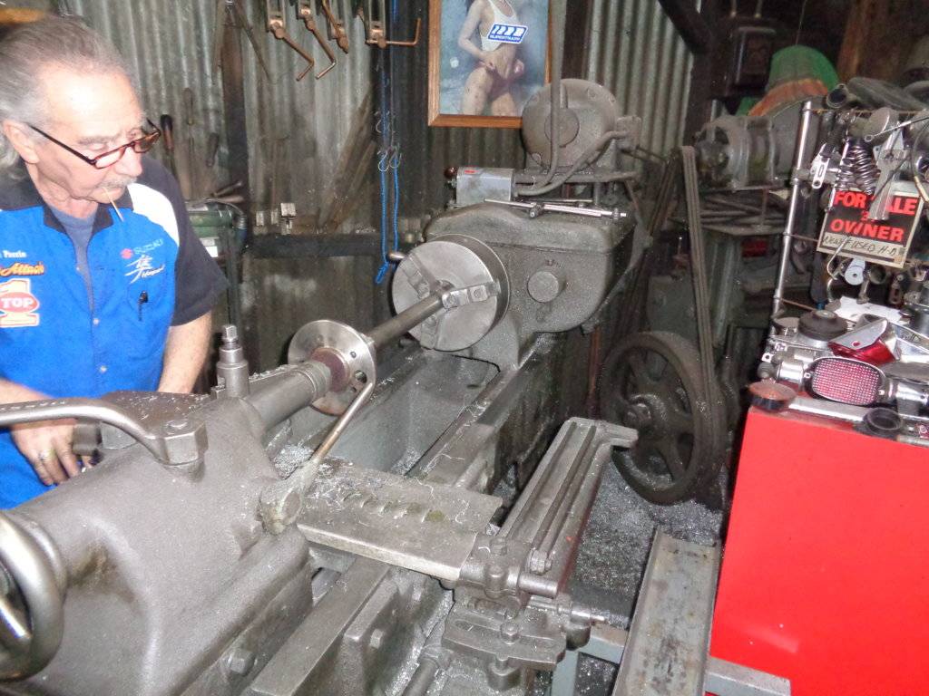

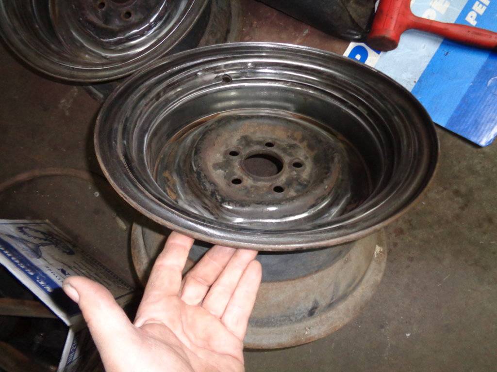

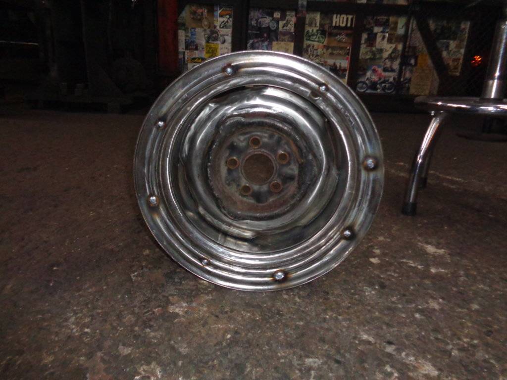

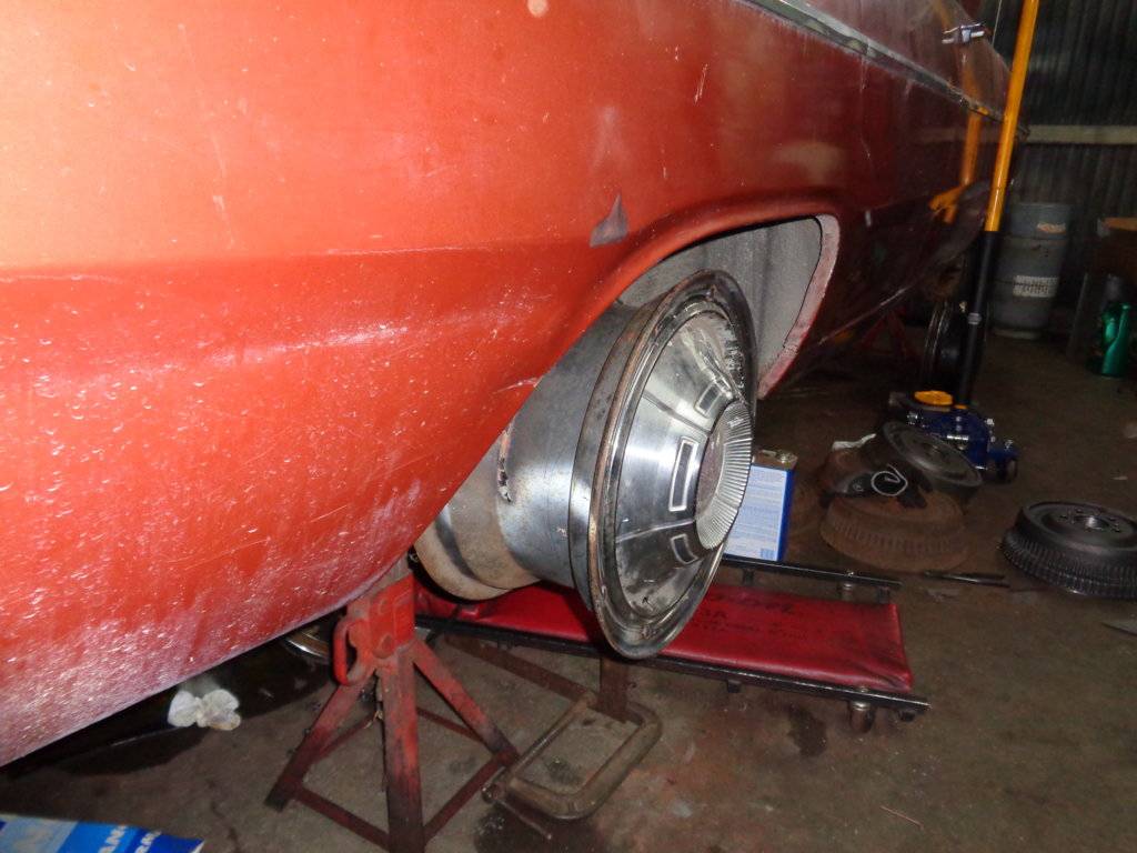

i made these for a small bolt pattern dart with these special outer bands i purchased years ago . the 14'' centers in 15''x8'' bands . and i made the 14'' wheel covers fit as well . pm me if you want some bands i have a couple left . and but my machinist / welder is closing down his shop soon . he's the main man behind the ack attact streamliner race bike , he will be spending more time on those projects in his new place

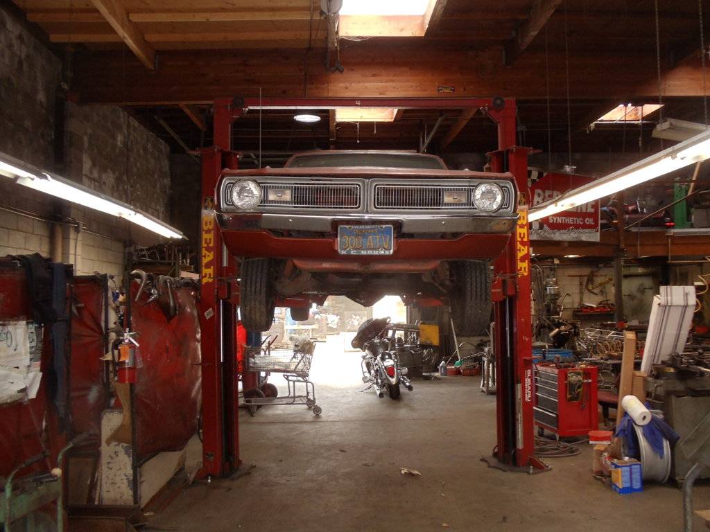

i've ground down those spot welds and painted them semi gloss black as the fronts on this dart , its a real sleeper . more door dart with full wheel covers . granny ride for sure . with a 500hp 440 727 w/gv od dana ls 4.1 . granny likes to get there quick !
