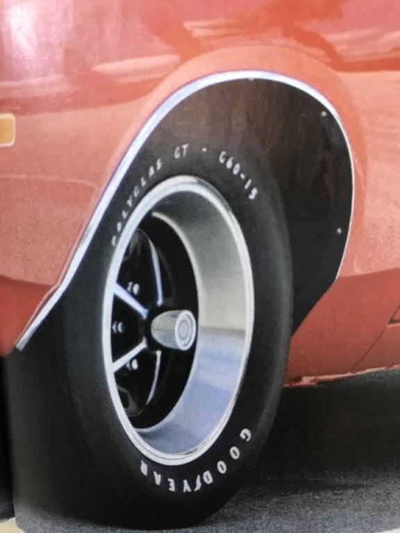

Looking at an article in the new MCG while getting my windshield replaced in my work truck and I saw these again.
I've never seen these in real life. Ive only seen them in print. Ive always thought some 15x7 magnums with trim rings would look cool and NOT be 14 inchers. Is that what these are or is there a source for these 15 inch road wheels. Always wondered about this.
It's the 72 Charger article in the Oct 2018 mopar collectors guide.
My guess is that they are chrome 15" road wheels/Magnum 500's that the owner put trim rings on to make it look more correct.

I really like seeing the trim ring on this 15" wheel.
If you study the differences in the "Magnum" wheels, you can spot a 15" Ford wheel pretty easily. That trim ring camouflages that difference nicely.
If you really wanted, you can take the centers from a 14" wheel and have it mated to a 15" "hoop" in your choice of widths. It's probably easier to buy a repop, but modifying the stock wheel would keep the stock look a little better as the center won't be chrome like the Ford wheels.

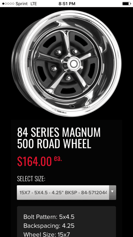

Year One sells repro 15" Road Wheels with a black painted rim for those that use trim rings.

Holy crap Dave. I KNEW somebody would know !!! Look at that price for a 15x7 why on earth would you ever buy used again ???? Thanks man I know what I'm buying for Xmas.
Note that the wheels do NOT include trim rings. The trim rings are extra and are $45.68 each for the brushed trim ring.
That makes theses wheels much more expensive than the Ford style all chrome Magnum 500 wheels.

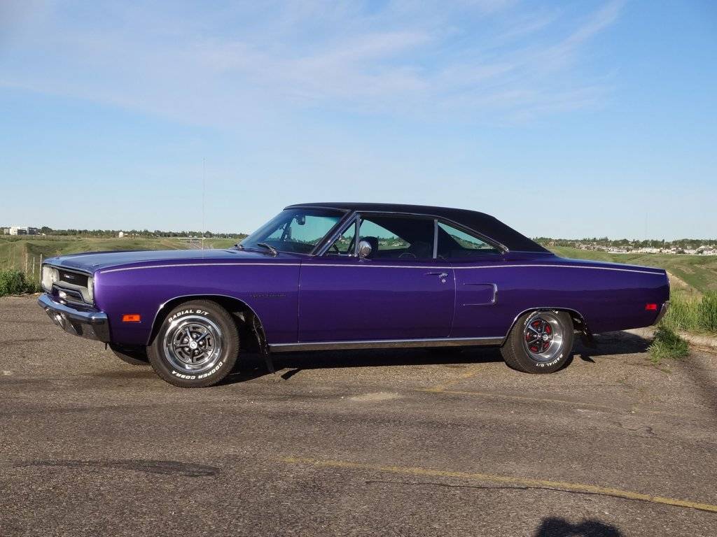

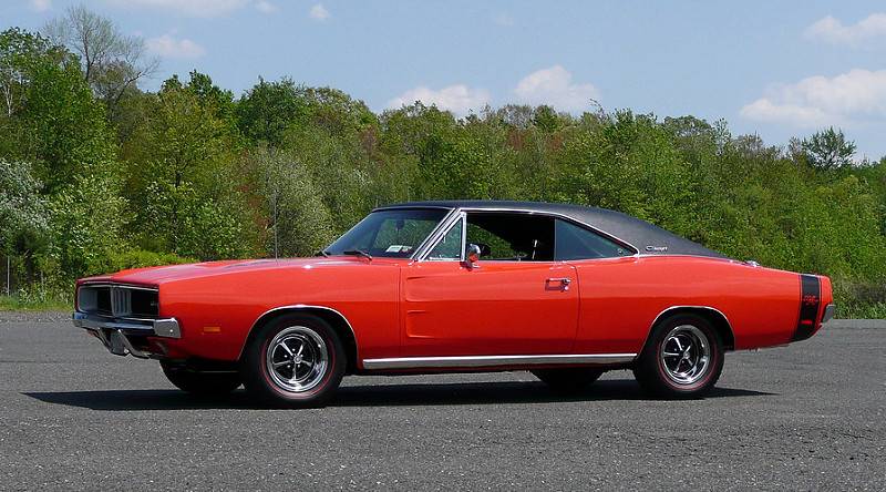

Personally that is the wheel I would go with as it looks like the Mopar Wheel that was offered in 1969-70. They look good on a b-body but 14 inch wheels are just too small. These in 15 inch fill up the wheel well much better. I would do some research before pulling the trigger to make sure there isn't more than one vendor and that the brushed trim rings were available. The chrome trim rings don't look right to me either.
Here are a couple examples of them in 15x7
Dave

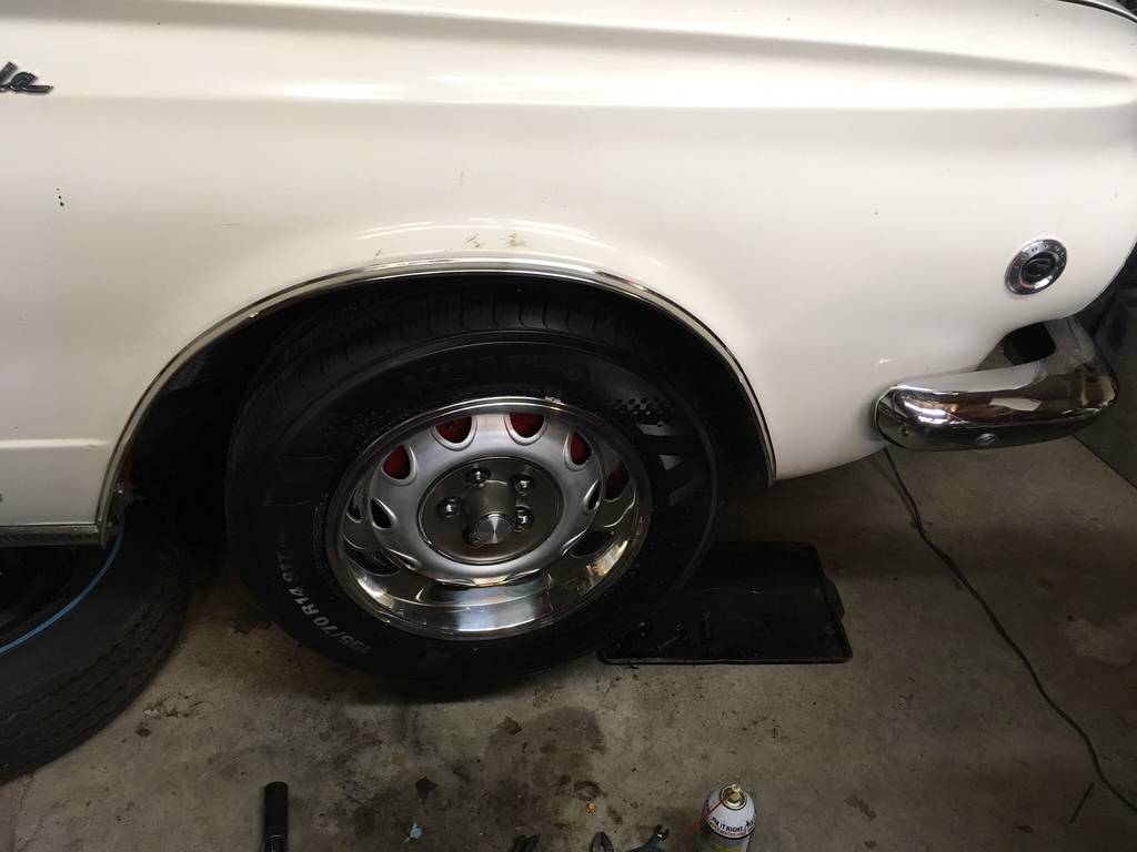

I like them but I'm trying to decide if I keep the OE wheel covers on the 65 NYr or go with some new shoes. Will definitely be a wider 15" if I change shoes on the car
