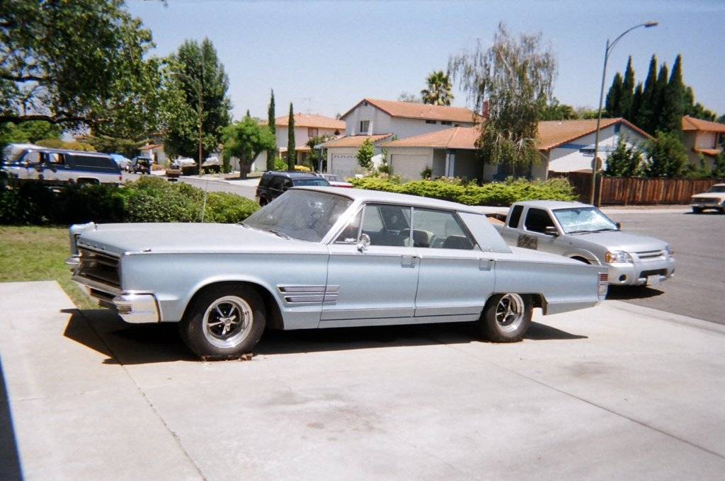

here is 15x8's on my buds 66 , we had to work on the skit latching to get some clearance . it also had 275/60's on it . smaller tire would have worked better . and my yellow 67 300 has 15x8 1/2's on it , but lots of mods were done here , b body re , so i could get 245/60's on the butt and 225/70's on her nose . these vintage american torque thursts have 1 1/4 inch positive offset . widen the track by 3 inches .
