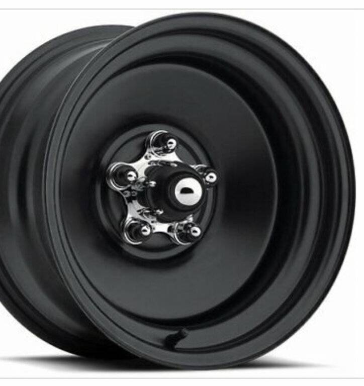

Will 17x8 rims for a 68 Polara 500! When I search these rims they only have charger,Dart or coronet to choose from?
[QUOTE="polara383500 When I search these rims they only have charger,Dart or coronet to choose from?

you need a 5 x 4.5 bolt pattern ( 5 x 114.3 in metric), but i dont know if there will be any clearance issues with the wheel openings - others here can advise on that
You need to know the back spacing needed in your application. What is the back spacing on the wheel you posted?
17x8 (5x114.3)zero offset 4.5 backspace with 245/45 tires fit on my 65 new yorker perfectly with no issues and my car is lowered.
Well all I can tell you is on my 69 Fury III on the rear I run 15/8 wheels with 4 1/2 back spacing with 275/60/15. They fit fine. But I don't think that will help you.
I run 17x8 4.5bs in the back and 17x7 3.5bs up front, 28.5" diameter tires on both in my 70.
